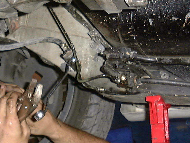

Here you can see the bottom half of the hydraulic clutch system as Nissan intended it. The hard line from the clutch master cylinder comes down to the lower block. This block has a loop back line that acts like a surge tank, taking pressure off the system. This is what causes the weakness. The short hard line then routes to the soft slave cylinder line. What we will be doing is eliminating the loop back and both blocks.
A closer look at the system
Here we are disconnecting all of the hard lines.

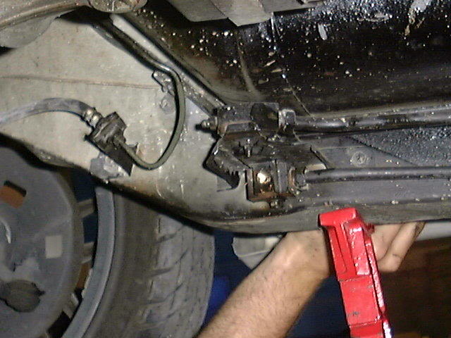

After removal of the short line, take the long line and carefully bend it by hand. Be sure not kink it. You will be turning it around and point it into the slave cylinder connection directly.
Here you can see the finished product.
Now go ahead and remove the loop back and blocks. Fill the master cylinder with brake fluid and bleed the clutch line. You will find bleeding this system takes only a few minutes, instead of all day like the stock system.
