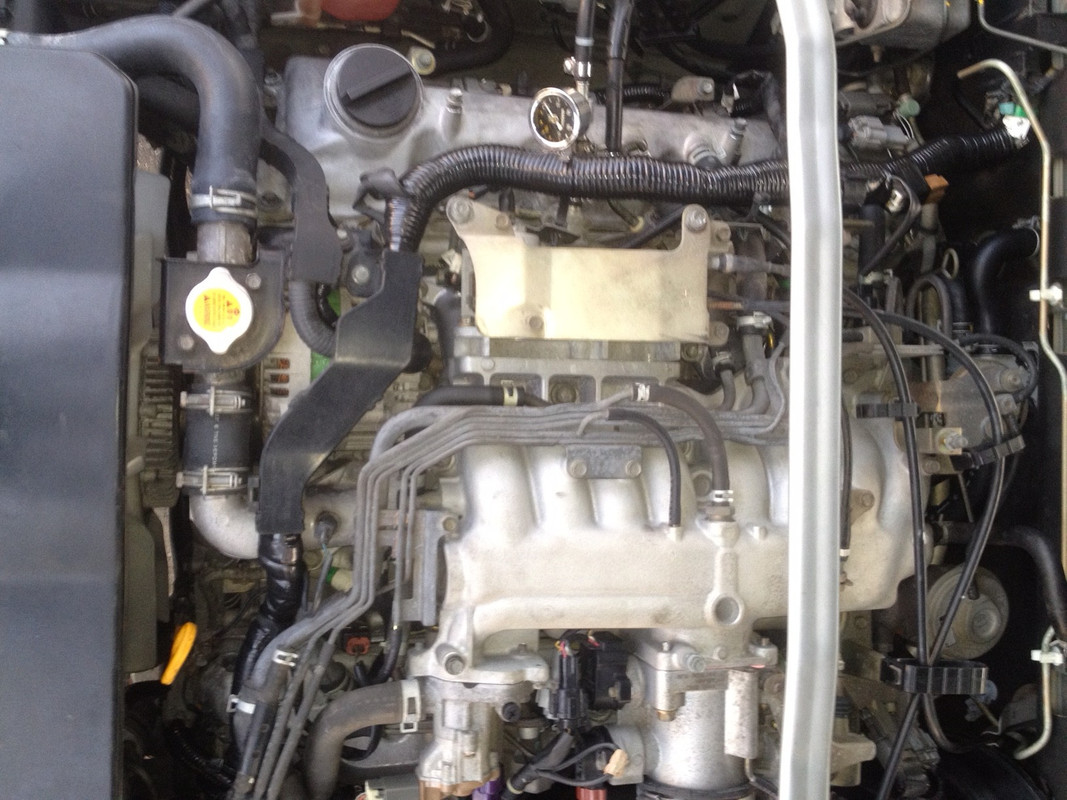

Here's a photo with upper plenum removed, should give you an idea, and I agree the throttle cable bracket should clear the way.
really really seat your #2 on the screw heads (I'd brush the screw heads first) so as to not allow any slip/strip. two small flat screwdrivers to pop it out. note the fuel pressure gauge I used to verify no leakage from injectors/rail prior to cranking engine.
replace both injector o-rings.

When you install the new viton rings on the injectors, use a little KY. Be very careful and gentle without high force.
