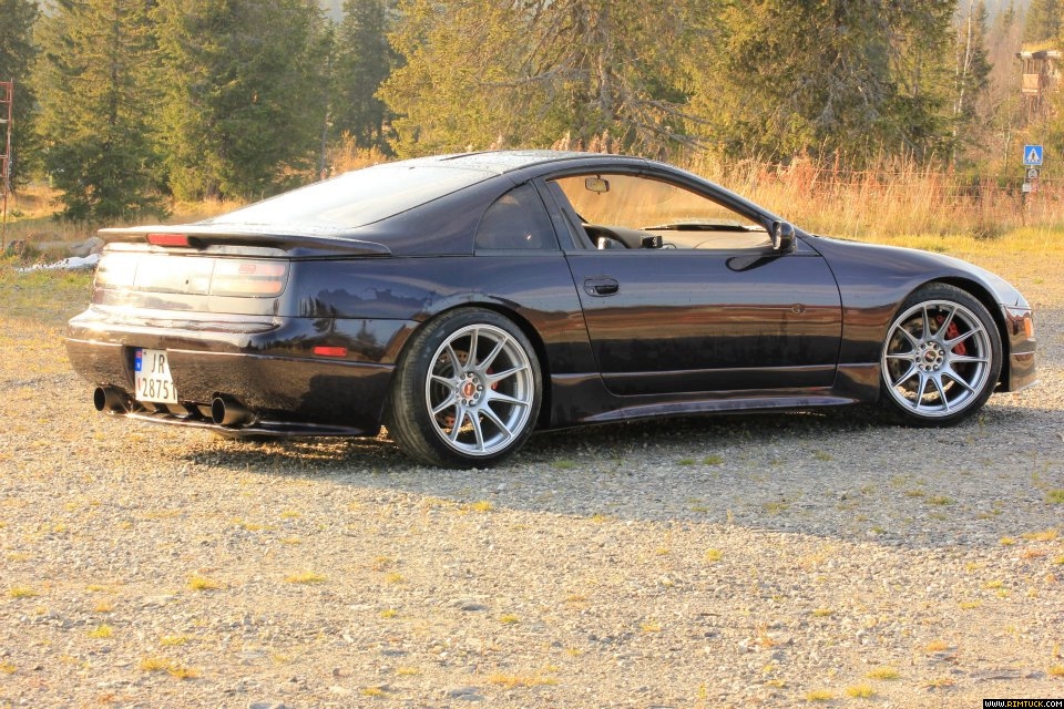

Went on rimtuck.com (great site! thanks Mr93z32) and looked through the 300ZX pix, the only ones that kind of caught my attention were:
and in second place:
TTkickedin: I'd like to stay around $5,000, maybe $6,000 as my budget. I looked at your 3 suggestions:
-Work Emotion CR-KAI: I'd choose over the other 2
-MB Battle: was ok
-OZ Futura: was a definite no :nono:
What I liked about the Emotions over the Battles is the fact that the spokes don't end at the edge of the wheel, instead, there's an uninterrupted ridge that goes around the whole wheel. Also, I like the look of the 5 dual spokes over the equidistant 6 spokes.
