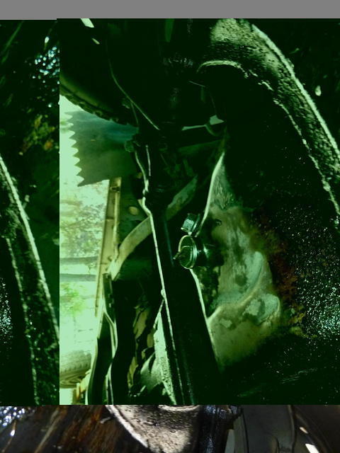

So, according to my dad, the previous owner of this 1978 Toyota truck had a hole in the oil pan which was plugged and patched with who knows what. A couple nights ago whatever was used to patch that hole had fallen out, leaving the truck stranded and a mess of oil behind it.
I don't think motor seized. The oil pressure light came on, I tried restarting it a couple times, and got just enough power to coast over a hill and roll into a gas station. I called AAA and it was towed back to the house.
This hole looks as if someone bored it out with a big drill bit, stuck a bolt in it, and sealed the rest with JB Weld.
Thoughts?
I'd like to avoid the task of replacing the oil pan.

Use a metal patch. Tack-weld it into place and JB weld around the perimeter. The tacks will be more than enough to hold the patch, but won't heat everything up enough to engulf your vehicle, and the JB weld will seal it. Hell, you could even goop RTV around the whole thing after that if you wanted to as well.
I can drive 100 miles to pick up a $25 oil pan at a wrecking yard in Idaho. Gas would be $35. And after spending a few hours reading Toyotanation and Yotatech, the pan replacement job looks reasonably easy since its a basic 2WD truck with no front diff.
The challenge now is in the puzzle, to see if I can seal it with something clever in case I run into this kind of emergency on another vehicle in the future.

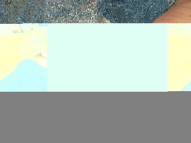

First I tried the stubby one on the left.
The instructions say to lube just the tip (lol). The wing nut clicks into place as you tighten it. Unfortunately, this one was a little bit too small. OReilly didnt have the 5/8 size in stock.
I then tried the universal one with the large pivoting wing nut that goes inside the pan and it worked quite well. The rubber sealed perfectly over the hole. Topped off the oil and ran it -- no leaks.
Unfortunately when you remove these, its hard not to lose the wingnut inside, so you have to fish it out with a magnet stick. I think it would be a good idea for everyone to keep one in the glove box for emergencies. Next time, he intends to get the 5/8" one for a more secure fit.
I again told Dad he should replace the pan, but he'd rather put a new one of these plugs in at each oil change. So be it. I suspect it'll only be driven ten miles this year after I fly home. For the rest of my week in town, I'm borrowing my friend's red 1987 Celica convertible. Sweet little car. Pics coming. :D
