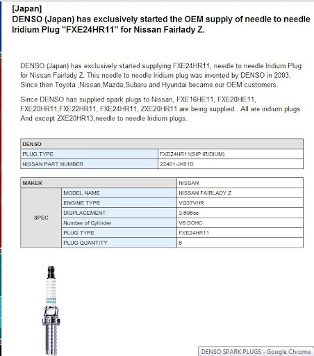

I actually had ngk typed in ,as it has been that way for almost 20 years.
Here is what I found.
I remember the G37 convertible new model class mentioning a new size spark plug (14mm socket needed)but other than that I remember very little mention from Nissan. It seems that this started in the Fairlady with the 3.7 engine. They started using dual iridium needle tipped Denso plugs with the VQ35hr motor in the 2007 G35 sedan.
http://www.globaldenso.com/en/products/ ... /12_1.html
I really did not know that. huh learn something new every day.

Interesting! Thanks for the update. I see they are using a plug with platinum tipped ground instead of a double iridium {center electrode and ground iridium tipped} wonder if there really is any advantage to a true double iridium plug over this single tip style plug?

I bet you there is no gain using double iridium. There are many possibilities, I started thinking about it and I came up with a few.
Differences in metallurgy might improve the spark.
The price vs. output rating would not be efficient.
Iridium supply is too finite to ensure supply and price point.
