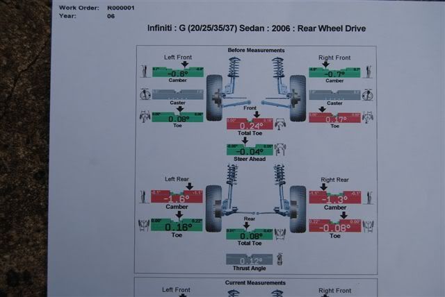

Before alignment

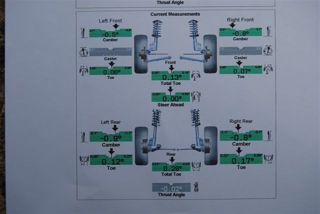

After alignment

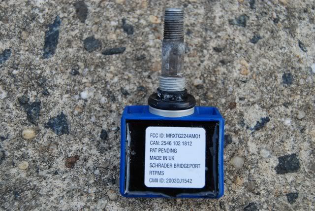

And one new tire pressure monitor sensor to replace this defective one
