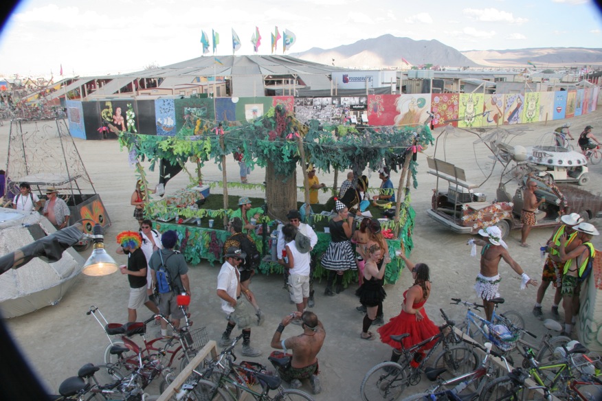

Yes, this is it! (if I've done this right anyway...)

Oh yeah, everybody shares their mods, I better too
Two high output alternators
4 batteries
3,000 watt 12v to 120v inverter
2 15" Mackie Thumps, 1,400 Watts of sound
1,200 watts of blacklight bulbs
200 sq feet prime astroturf
six to eight coats of Krylon fluorescent green/yellow/red spray paints on all the foliage
front and rear proximity warning systems
