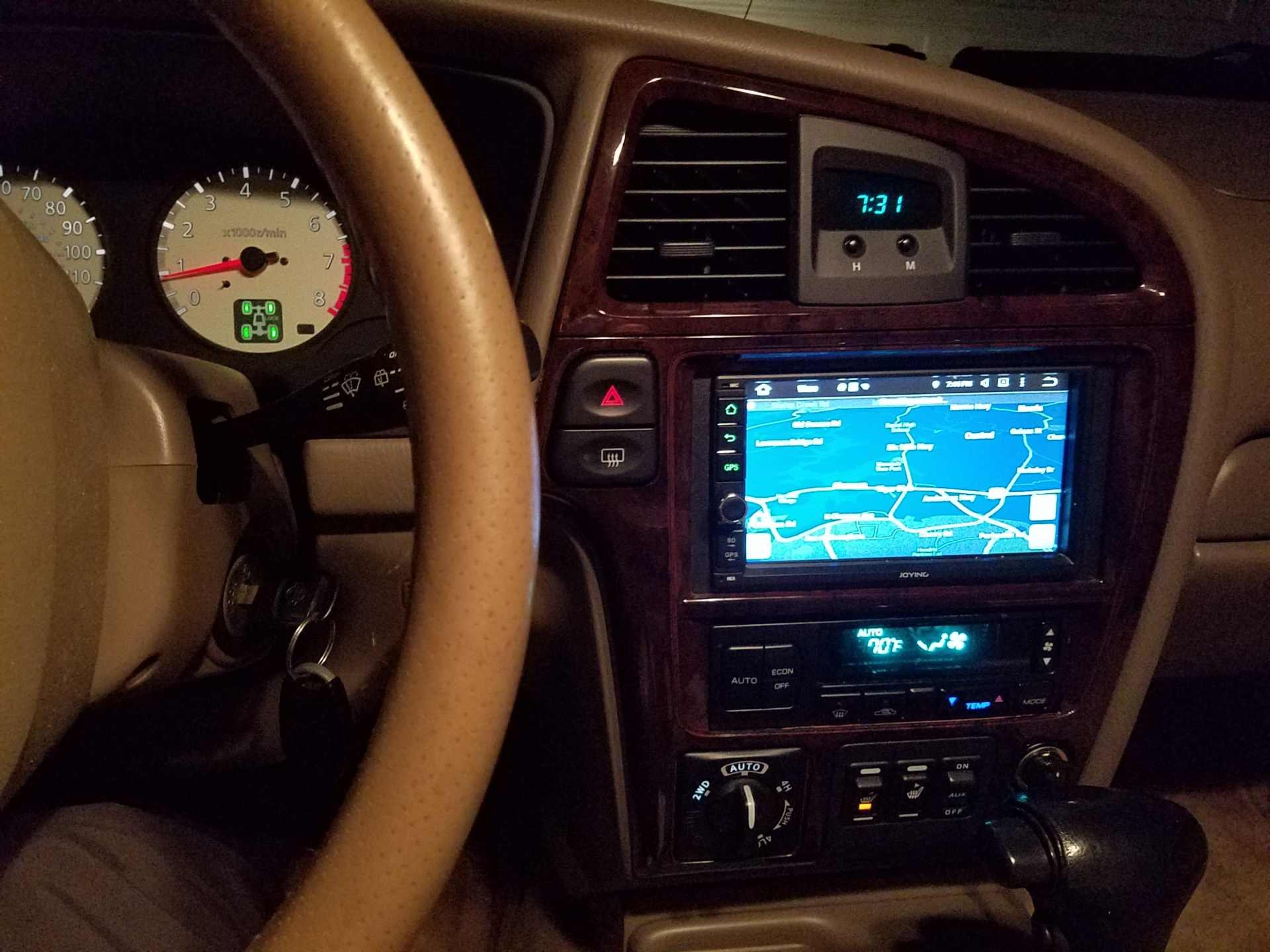

Here's mine, my Pathfinder had the factory NAV so I was able to use the same bezel.
