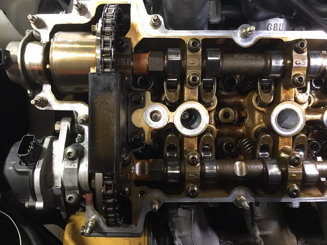

A peek at VH45DE internals 1525xx miles

I bought this one in April 2007 with 107k. It had had pretty regular 3k dino changes from 70k to 107k. I've been running GC or M1 (mostly M1) for the last 40k+
Had to do vcg's. I'm quite happy with the cleanliness.

Pretty clean for the age.

Ozzie wrote:
Thu Mar 28, 2019 2:16 am
thanks AUS-man! She's a keeper.....even though it's getting harder and more expensive to find parts to keep her going strong...
Posts: 54540
Beauty!
Mine looked like that at 120k.

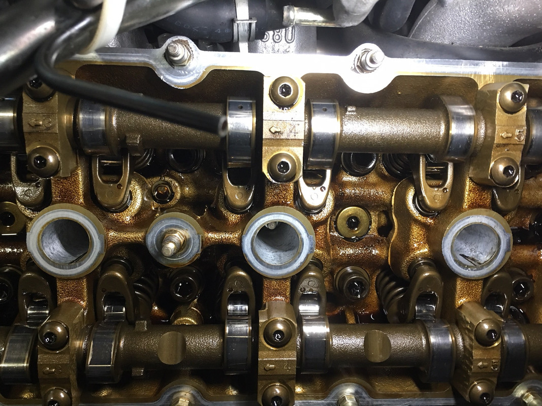

The engine valve /cam photos are pretty good in most respects. There is no sign of excessive wear on the cam, and there is no sign of sludge. However, there IS HEAVY VARNISH.
I suggest adding a pint of Marvel Mystery Oil to the oil and changing the oil at 1000 miles, repeat at least two times. MMO is very good at softening the varnish so a good high-detergency oil can dissolve the varnish. SYNTHETIC oils ARE NOT good at varnish removing. Some would suggest using a pint of ATF. I do not.
The varnish build up results from infrequent oil changes, bad (high varnish and gum) gasoline. There are parts with very close tolerances (valve lifters for one) and oil rings the varnish will cause to stick.
I am an advocate of 'take it gentle' when trying to clean-up varnish. Many 'quick flush' products can cause old 'rubber' seals to swell too fast and crack.
Once again, synthetic base oils are NOT GOOD VARNISH removing oils. They have POOR solvency. Actually, cheap 'dino' oil is the best for cleaning up varnish. Just avoid WOT runs and hard driving with them.

Anyway, you bring up an interesting point on the detergent vs solvent qualities of synth (group III base stocks I presume) oils. I've seen other VH45DEs wtih purple hard varnish all over, so I wasn't overly concerned with the soft varnish (as an aside, I could easily remove the varnish with a blue paper towel and easy hand pressure from smooth surfaces).
I think it was jamesmost a few years ago spun a rod bearing using heavy solvents in the oil (of course he beat the piss out of his engine too)....so I'm not likely to go the MMO route. What do you think about lubegard red (synthetic LXE whale oil) mixed with engine oil? I believe LG red is good at breaking down solvent (we used it in the multivalve).
