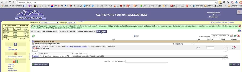

Here ya go - $5 cheap enough?

Lol yes sir it is, but my guy says I need the one that doesn't flex.
