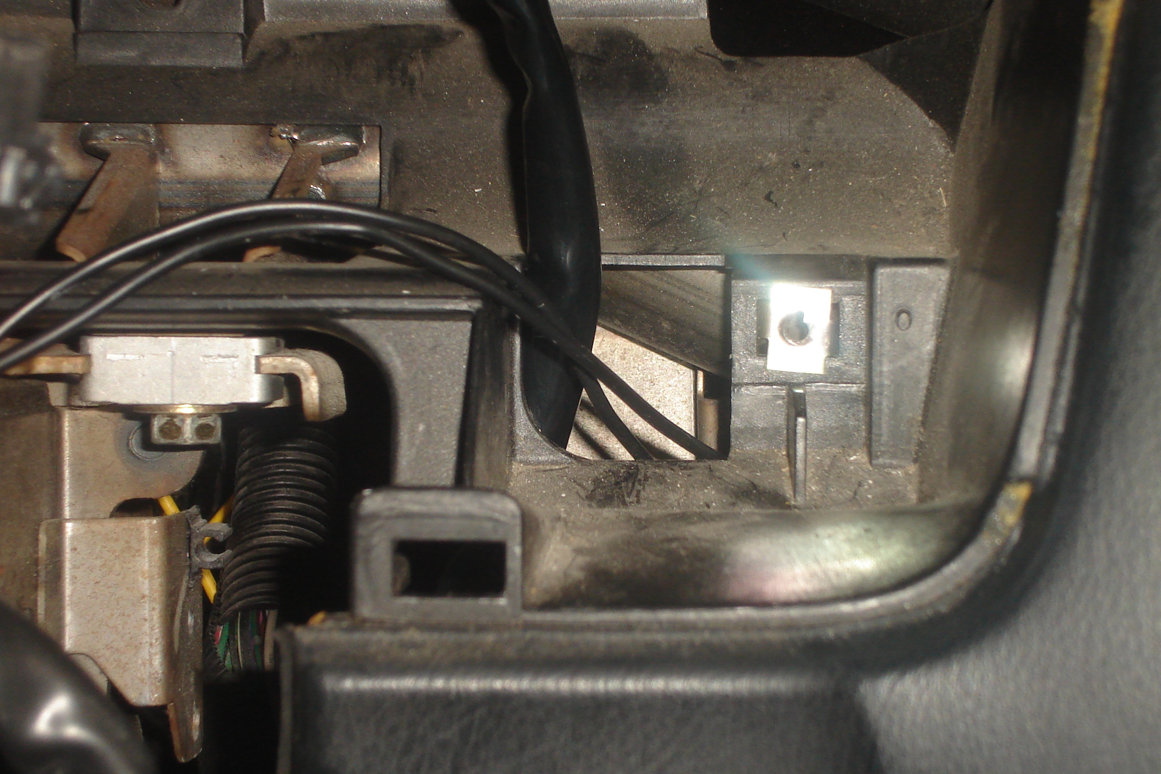

route the tt harness through the hole in the dash to the lower area of the dash

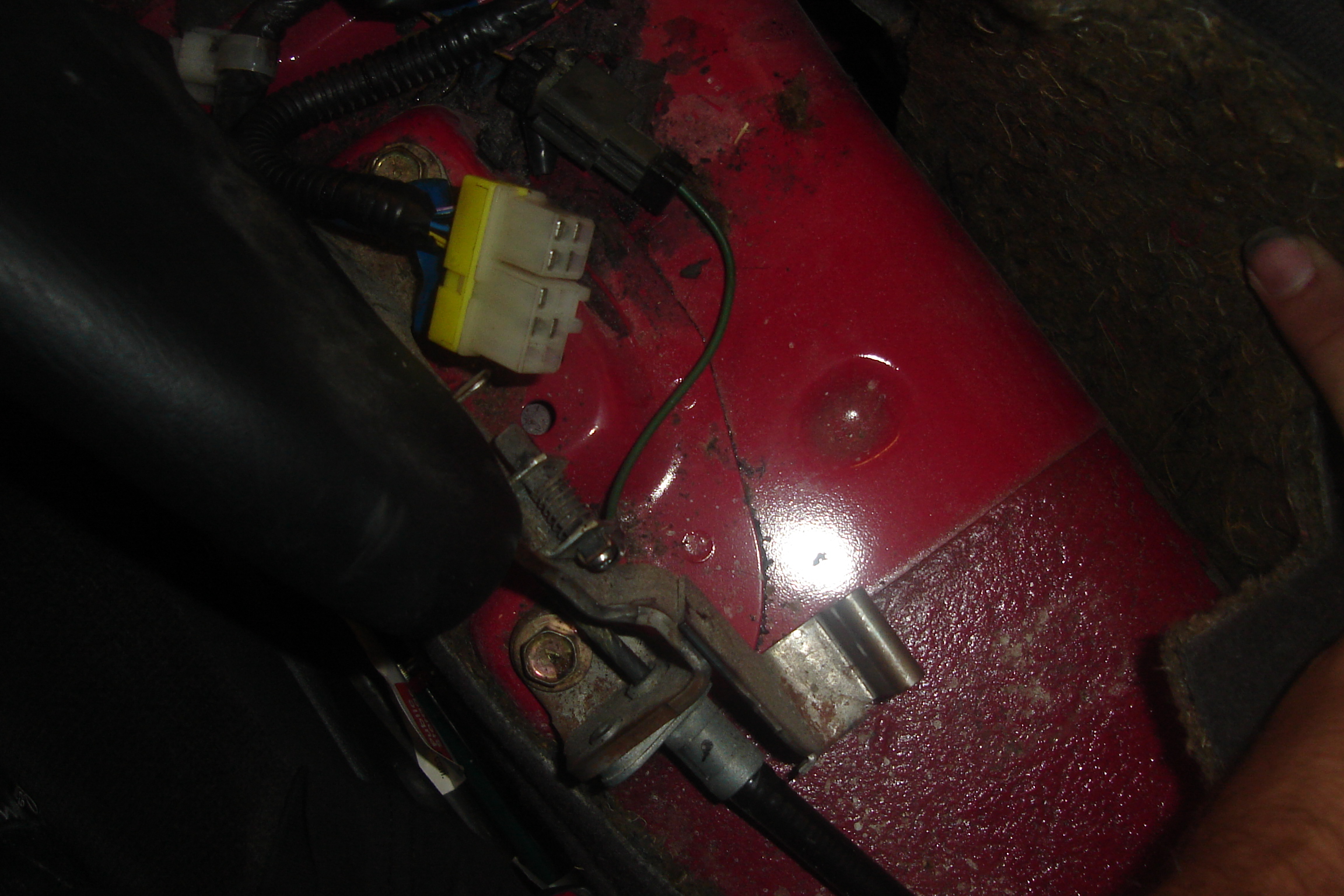

next you will have to remove the center console to continue the installation by removing the 4 screws 2 at the very front of the console and the 2 under the lid. dont forget to unplug the power mirror harness from the console.

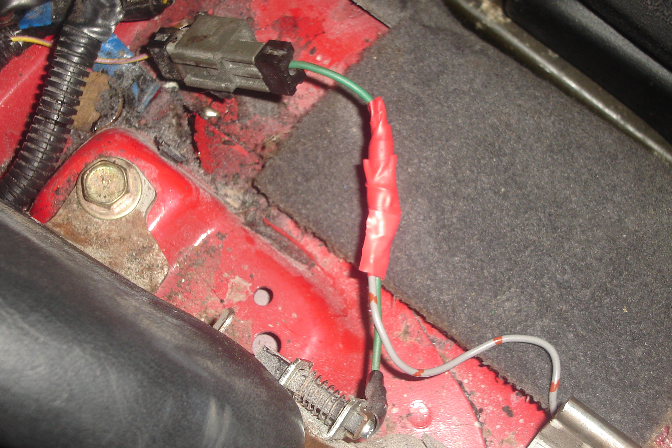

connect the Grey wire w/ the unit to the Grey wire extension supplied with the unit
look for the wire hooked to the e-brake
hook the Grey wire extension to the parking brake wire as such
next connect the blue wire extension to the unit this wire is used to read the speed of the vehicle . the instructions say to hook to the blue wire to the ecu but i hooked it to the connector on the back of the instrument cluster. by doing it this way it provides a way to cut out the speed cut. run the blue wire through the hole that you ran the harness through and connect it to the yellow green wire on the white connector on the top of the cluster as shown.
