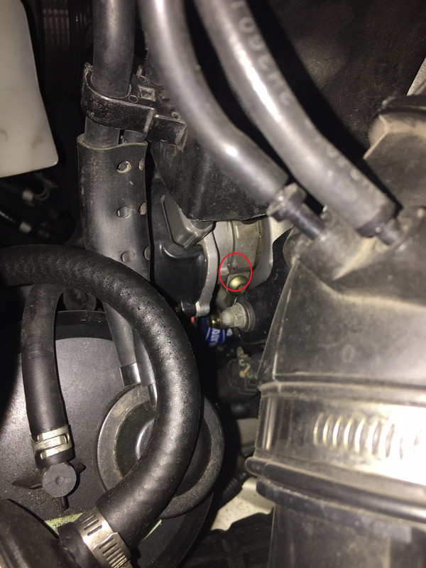

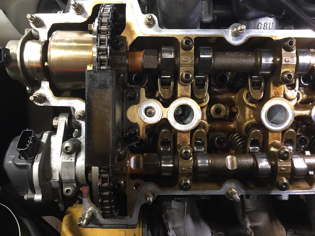

Where the red circle is. there is a sharp ridge on the body of the sensor, it should clock about where the valley is on the camshaft cap. That should get you close enough to start it if everything else is good.
Here's another shot from my '95
