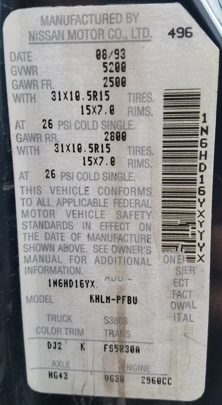

As a newbie and fellow Nissan owner, I thought this group may help me... here is my story/request:
I own a 93.5 Nissan 4x4 SE V6 King Cab pick up... will be installing a new "4 Wheel" camper in December...the first year I owned the p/u, I was sideswiped and had body work done that removed the FMVSS Certification label(driver side door panel) that listed all the info including the GVWR and GAWR ratings... I called a local Nissan dealer who spent 2 days researching with no luck either from his online search nor from Nissan techs... boo hoo!
So am asking if any members have a similar p/u either 93 or 94 ... could you pass on via a post info from your sticker about the above axle and vehicle "weights"... ideally, if you can, I would love a photo of your sticker which I can save/print and keep for my records...
If it helps, here is my VIN # 1N6HD16Y7PC-373228 (fr. my original posted sticker when I bought the car)... am anxious to see if anyone can help... thanks... Brad

Car: 1993 Nissan 4x4 V6 Extended Cab Luxury Package w/Popular, Convenience and Functional
HG43 Axle with H233B rear / R200 front, 4.375:1 gearing with LSD
FS5R30A Manual Trans
