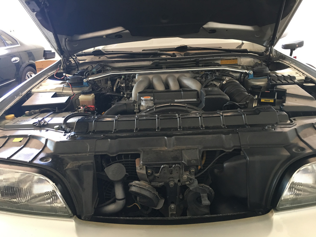

I looked at the ebay bar linked--it appears to be adjustable width, good.
You will need to drill a hole in the hat. It also looks like the bar height might be a little different. as long as not too high so you can close the hood......
on the silver '94, I have about 3/8" clearance between the transverse cavity of the upper plenum and the strut bar, so width of the bar (fore/aft) and height of bar above the hats are also considerations.
Question for Heath on TCUs....As I drove the '94 this morning (68u10 TCU) I was reminded of how when rolling gently to a stop, the trans shifts 3-1 at closed throttle, not 3-2, 2-1. This has always annoyed me (acknowledged that it may extend trans life by requiring fewer valve/clutch pack/band cycles), and interestingly, the '97 (FGY33) when I had it did the 3-2, 2-1.
So my question is: do you know if the 64u20 (or even the countermeasure 64u75) shift 3-1 or 3-2,2-1 at closed throttle?
Q451990

OK, I don't know that I'd call it 'weird'---could be by design. Anyway, if you wouldn't mind taking note the next time you have the Black Beauty out for a drive, I'd be interested to compare notes.
Apologies to the OP for the slight hijack.

No worries @3QJay! That engine bay is CLEAN! :cool: It's good info, you guys know what you are talking about and I'm always interested in learning.
