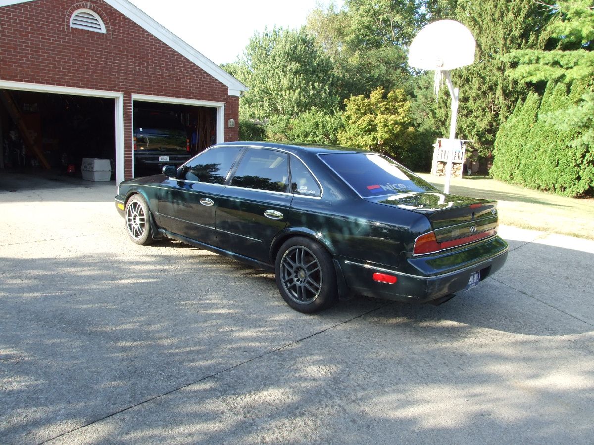

Heres a picture of the Q I took in september when I changed my drivers side seat

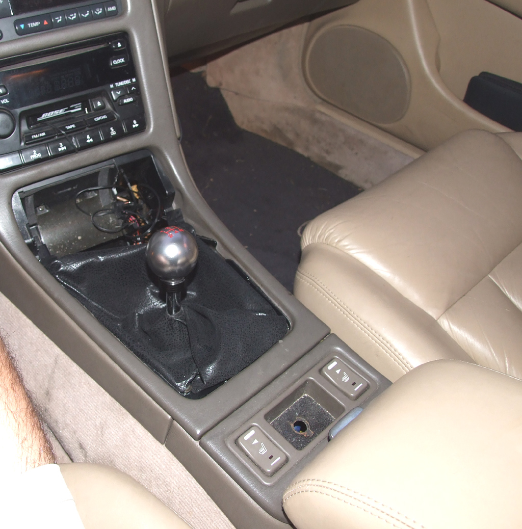

I also thought some of you would like to see my latest mod to the Q.. After being about 90% complete, I am finally about 5% closer to being COMPLETELY done with my 5 speed swap..
I had a round of 5 speed adapter plates made at my machine shop, and since they were open and I had the day off, I decided to let them tackle modifying the shifter in the car to fitting inside the stock OEM trim piece..
Overall I have to say they did a fantastic job.. Workmanship was great, and I would easily say that if I had tackled this myself they easily did a better job in much less time... On top of that, I ended up spending less money that I was anticipating..
Here is a picture before.. As you can see, the shifter sits way too low and not properly centered.. Overall it looks bad especially for a luxury car
here is a picture of the new shifter... What my machine shop did was weld a piece of stainless rod onto the existing shift rod and bend it into place.. Very simple and it works and looks great.
Here is a picture of the completed deal.. Sorry for the crappy pictures, but the idea is there...
As far as anything new I'll do, I will probably get away from the round aluminum shift knob and go to a standard leather shift knob like whats used in a Z32 300ZX or a 240sx..
