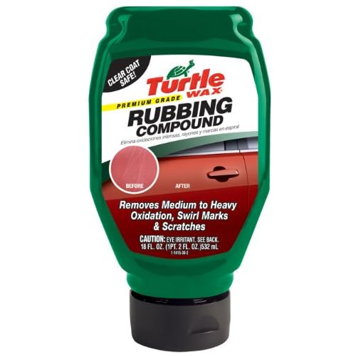

I shaved my emblems off today. It wasn't hard at all. I'm assuming because it's a '13 model and they weren't sitting for years on the car. A quick overview on how I did it.
I used dental floss to remove the emblems. (Any Dental Floss with work)
Then use your fingers to remove the 3M tape thats still on there. (Don't use your nails, you may scratch your car)
Then I used Turtle wax Label & Sticker Remover (Safe to use on cars)
Then I finally used Turtle wax rubbing compound. Use a soft detail sponge with this.
Then finally here's the result. No ghosting, or scratches. It looks flawless.
