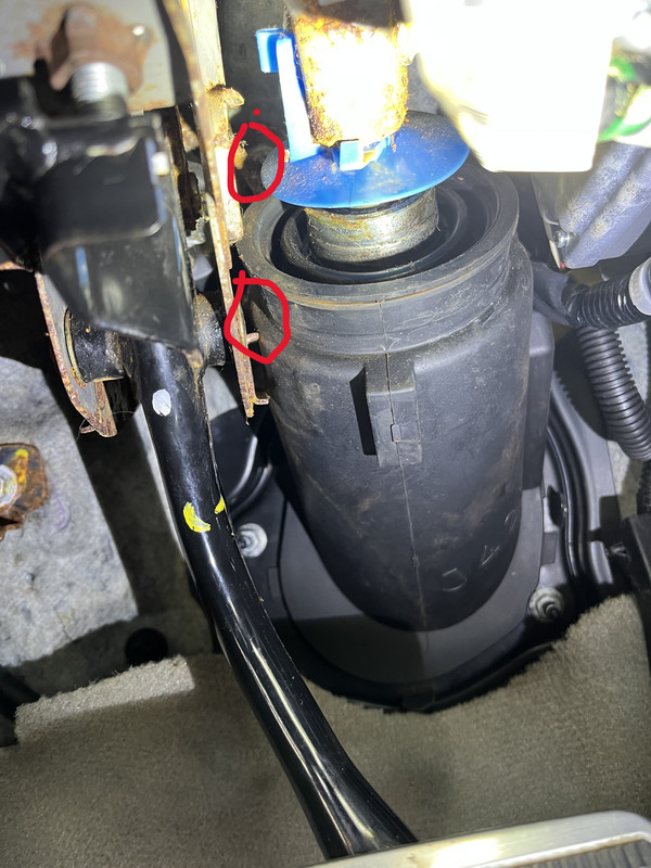

hello, does anyone know to remove the right upper and right lower brake booster nut from inside the cabin behind the steering column? i tried to squeeze and pry the rubber steering column boot to the side but still doesn't have enough space for a socket. here's a photo of the brake booster where the nuts are circle in red. the right lower left is behind the boot.

I've never done that operation on a G specifically, but in general the only way to reach many of the booster nuts is with a long extension and a shallow swivel socket.
