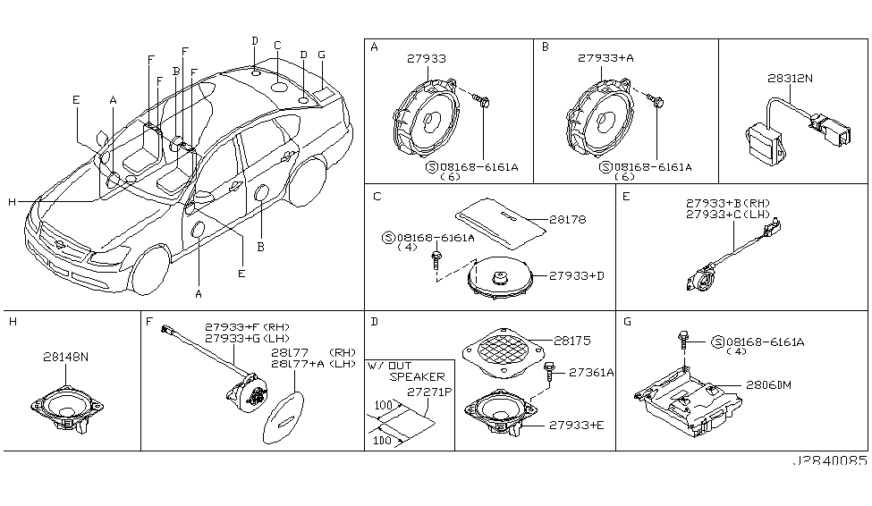

Hi. I have a 2006 m35 Base Model. I am trying to find the location of the amplifier because I need to change it. On the left side in the trunk compartment, where the infiniti diagram shows it is supposed to be, is my tire jack equipment. On the right side there is nothing. Can anyone provide any help?

It won't be near the jack, it will be hanging off the bottom of the back deck (rear parcel shelf). Look up, not down.

What version of the M do you have? The back deck is the flat portion directly beneath the rear window, Nissan calls it a parcel shelf in the FSM. The Bose hangs off the bottom of it, accessed from the trunk.

Are you sure it has an amp? The base system doesn't have one, the speakers are driven directly by the head unit. The FSM shows the same location for all the variants with Bose, under the left side of the shelf. So if it's Bose and the amp isn't there, somebody has to have modified things.
