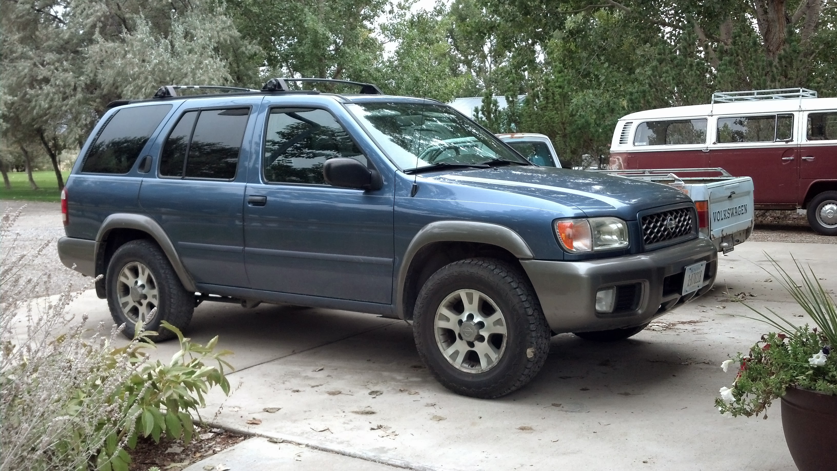

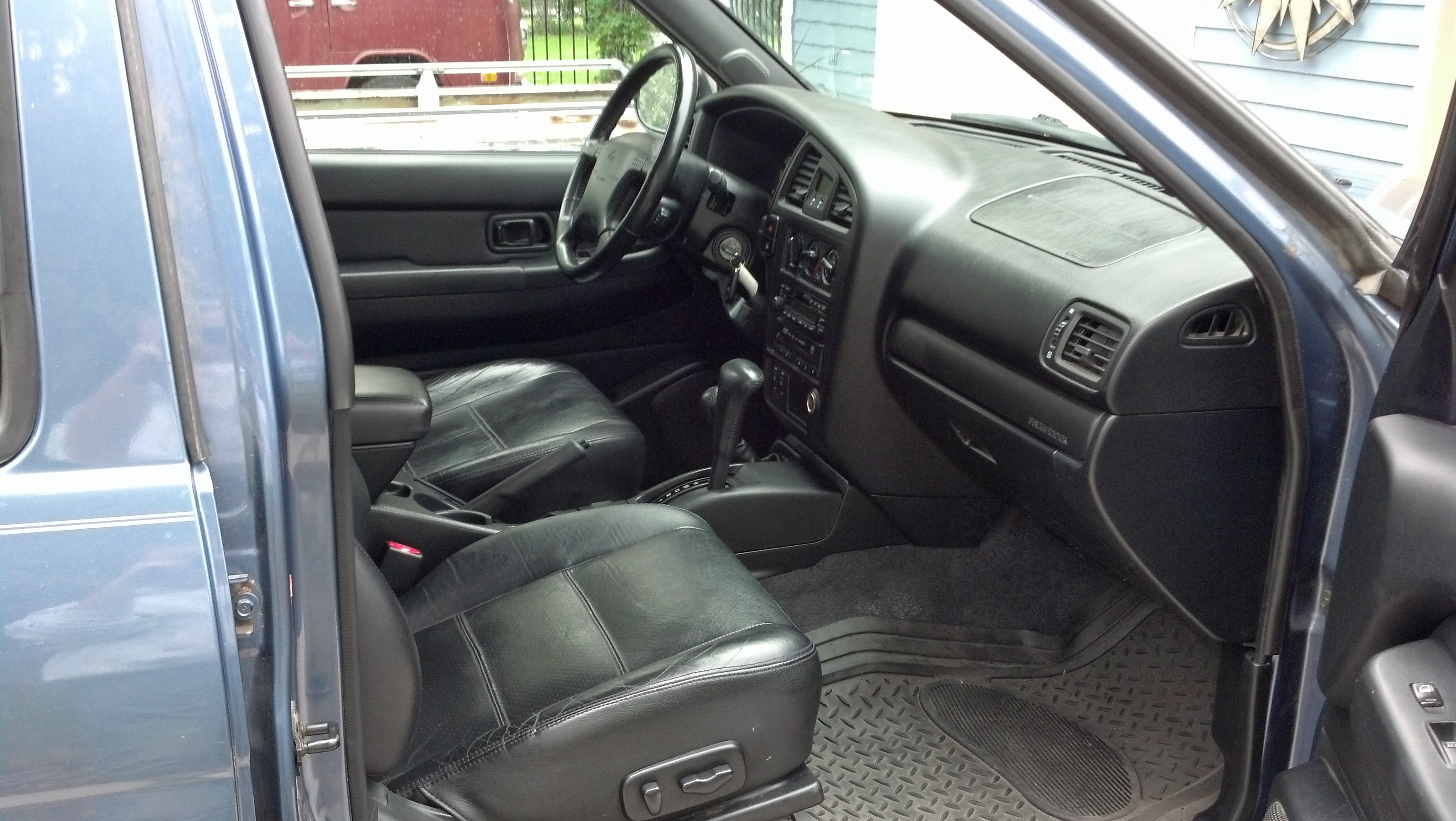

Hi everyone, I just picked up a 2001 SE a couple of weeks ago and this forum has been a great resource. I'm normally a VW/Audi guy, and this is a nice diversion :biggrin: I thought I would share what I've done so far, throw out some pictures, plus I have a couple of questions:
--Runs and starts great - but it's sluggish above 3K RPM's on WOT.
--Swirl valve appears to be functioning - tested by putting vac to the valve.
--No codes.
--I got just over 200 miles on this tank.
Any suggestions guys??
What still bugs me and I will fix:
*Sluggish about 3K RPM's
*~200 miles per tank
*New plugs
*I will clean the MAF this weekend
*Right front mud flap is missing
*Lots of rusty bits, salt roads as it is originally from Michigan - I need to check my front fenders :ohno:
What I have done:
*Cleaned it up, vac and a wash
*Fixed oil cooler leak
*New ball joints
*New upper sway bar endlinks
*New rear tires to match the front that were new
*Alignment
*Removed an extra exhaust extension over rear axle
*Cleaned and lubed the vent control valve, checked for evap and vac leaks, none present
*Ran some Lucas injector cleaner on one tank

Welcome to NICO. Nice clean Pathfinder and an immaculate engine bay!

Pretty good looking truck!
