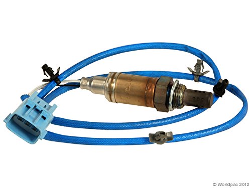

Just a quick heads up if you have a 2001 Pathfinder or QX4 and are in the market for new oxygen sensors. You will probably find that some sensors are marked as early or late production with no explanation of what that means, exactly. Spoiler: early production means 2001 models, and late production means 2001.5 models. If you're not sure which camp you're in, check the production date on your driver's side door jamb: dates 01/01/2000-08/31/2000 are 2001.0 model years; 09/01/2000-06/03/2001 are 2001.5 model years. The other time this date is significant is when you're shopping for ignition coils, but that's a different thread ;)

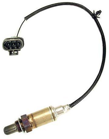

Here's an example! Here's the connector used on the 2001 downstream right sensor
and 2001.5
Note the connector is completely different. They're even a different color.
You'll probably also find that there are also universal options available as well. I don't have any first-hand experience with them, but my understanding is they're sold without the connector, so you simply cut off the old sensor and tap into the existing wiring. My guess is all three options are exactly the same and the only difference is the connector they ship with and possibly the wire length.
I noticed that Denso doesn't seem to make the distinction between 01 and 01.5 so while they're a reputable company I wouldn't buy from them because there's no guarantee which connector you're getting. On that same note, don't trust a parts counter that doesn't ask which one you need. You're best off picking ahead of time and simply handing them the part number you need.
Good luck!

I actually have an update of my own: I bought new upstream sensors for mine as well, and got the Bosch 13224 for the driver's side since it was specified by Bosch and every other parts store as being the replacement part. Like a fool I took their word for it and didn't compare to make sure. Long story short, it couldn't have been more wrong. The connector was completely different (I'm guessing the same as the 2001.0 uses), and the cable was only about 10 inches when it needed 2 feet. Even the wires were a much larger gauge than the old one! I ended up getting the 15363 instead, and it was a perfect fit. The peculiar thing is that 13224 is specified as the replacement for 15363, and as such, the 15363 isn't officially available any more. I was able to snag one of the few remaining off Amazon because none of the local parts stores couldn't source one.
I don't know what's going on here, but I'm pretty cranked about the whole thing and will be getting ahold of Bosch to request they get things straightened out. In the future, if you're in need of the 15363, I recommend getting NGK/NTK or some other brand instead, and make sure the pictured item reflects your setup.
On a related note, the 15343 was a perfect fit for the passenger side.
