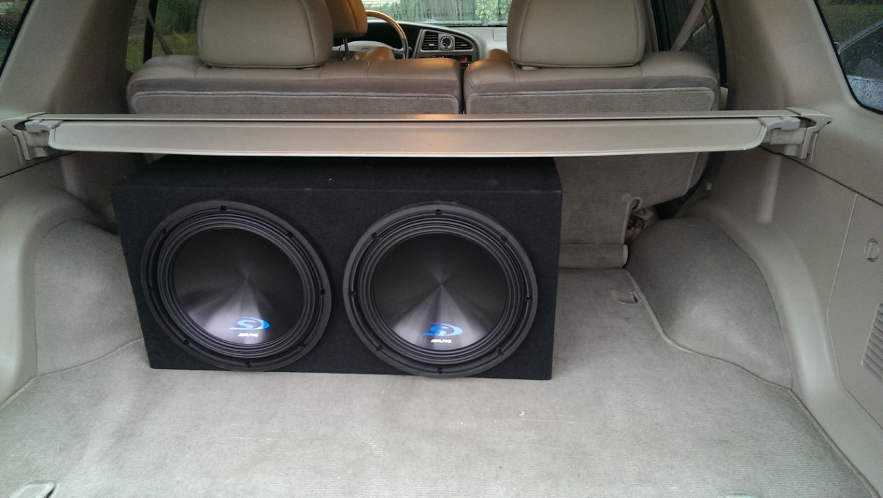

The subs already take up a lot of the space in the rear anyway and there is a good amount of space right next to the subs that is already being wasted. I wasn't thinking about a cap but an isolator keeps the main battery charged therefore not stressing the engine, and charges the auxiliary battery when there is extra power, correct? Or is the difference negligible in terms of stress on the engine? That is all I'm really worried about, currently the RPM's jump whenever I hit a low note. I'll post a pic of what I was thinking.
I'd also need a new fuse if I run 0 gauge wire right? Any suggestions? Not a show car all I care about is how loud it is, louder being better. >:)
Edit:
Here it is, was thinking of shoving a battery in-between the subs and the wheel well on the right.
