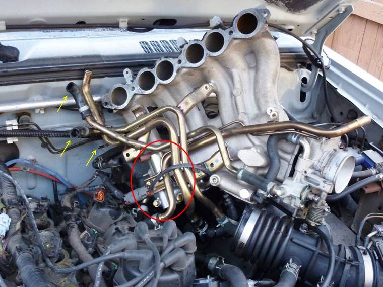

Yes you have to remove the intake manifold. Mine is leaking too, LOL! it has been for weeks. here's a pick i found of the coolant hose(s). Might as well replace the PCV valve too it's under there. And clean the IACV. So there's more than one thing to do while you have it off.
Edit: Those aren't my arrows or circles they came with the picture, the hose(s) you want of course are the front ones.
Let me know what hose you get. mines leaking on the drivers side also.

This is very intimidating hahaha

Hey I just went and took a closer look and if you work at it you CAN replace the hose with the bend in it without removing the manifold. If you look you can get to both ends and if you can't get the spring clamps back on try using the screw type as a replacement. Also put some vasaline or some kind of lube on the ends before installing new hose to make it easier to slip on.

I just finished doing mine, took under an hour. You can do the long one with the bend in it without removing the manifold. I did remove the distributor cap and move it out of the way for better access. I dropped some 3-n-1 oil on the metal parts before installing the new hose, slipped right on! I used 1/2" heater hose, it works until i can take the original to the parts store because it has a molded bend in it. :facepalm: its so easy i plan on doing it again, hahaha. :whistle:
The short straight one you can not get to without removing the manifold.
