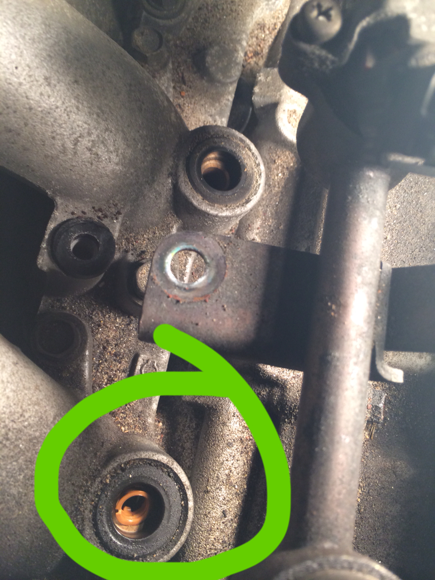

I just pulled the upper intake/plenum (the part on top of the runners that the throttle body attaches to.
I found the rubber gasket had wet, seemingly fresh oil on it. Does engine oil run down the enter of the plenum? If so, do they ever develop a leak inside....which would allow engine oil to go into the cylinder, which may be causing my plug fouling mystery.
I took some pictures. I'm pointing w/ my finger to the very front part of the plenum where two rubber hoses meet at a circular connector at the middle of the plenum. These leaked oil when I pulled the plenum off the motor. I assume that's where the oil flows into the plenum.
I also drew pointer to the wetness on the gasket.

forgot the pictures in my last post, but I can't figure out how to get a picture posted. sorry for my ignorance, can someone tell me how to post a photo here?

Found the problem!
I got the plenum off and pulled cylinder 1 fuel injector. There was a broken piece sitting in the port.
Put a new injector in, buttoned everything up and she runs smooth as silk. No more rich fuel smell, no more rough idle and no check engine light.
I put about 400 miles on the car with it dumping fuel into my exhaust. Do you think I've ruined my catalytic converter on that side?
I did just change the oil. I'm sure the oil was diluted with gas.
I'd like to post a picture of the broken piece if someone can help with posting photos. I tried cutting and pasting, but that didn't work.

If you email me the pictures I'll post them for you. [email protected]
Congrats Don, you had the first reported failure of an injector on a Y33 (97-01) Q that I've heard of.

Here's the picture..
Anyone's best guess what that is? I have a feeling that whatever is in there wasn't affecting the injector, and just the injector itself was bad.

looks like a pintle cap cover for the injector. ive run cars with and without them but that could certainly be causing your fuel to be pooling and not properly be atomizing into the intake tract. pull it out and A) retry original injector or try a new one you should see a difference.
