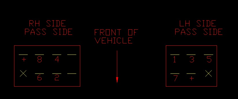

    Man you guys are the best. Like you said they would my injectors tested good OHMS wise. One question about that though if I have an injector sticking open will the OHMS be off? Also here is some info on testing the 98 injectors. Connecting to the positive terminal of the battery didn't work but there is another way to test without removing the injector.
    First view the diagram that I have attached so that you will know which pins belong to which injector. Notice that the connectors for the 98 have other pins in the connector. 5 on the drivers side and 7 on the passenger side. To test each injector connect the positive lead of your multimeter in the ohms setting to the + pin and the negative will be connected to the corresponding pin for the injector. Might be a slight variance due to testing through the wires but its is fairly precise. 10 - 14 ohms is the range.

    Here's the picture that you sent me. I had AutoCAD open so I took the liberty of making something a little bit more clear
