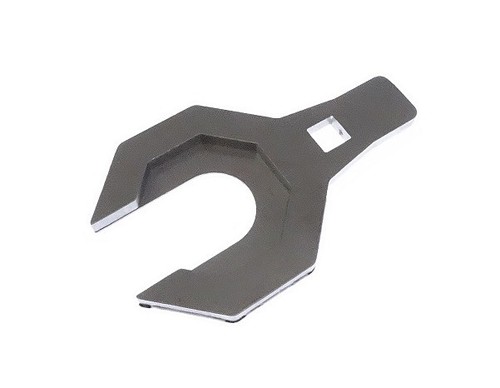

What tool do you use to tighten that shock collar on-vehicle? Right front shock is making a racket, it needs attention now.
Do you put a floor jack under the LCA to compress the spring while tightening the collar?
Something like this? I unfortunately already mangled the LF a bit with a pipe wrench but it is still quiet.

that looks like a cool tool! I just used a big pipe wrench.....
i would compress the spring just enough to unload the tension on the strut.
