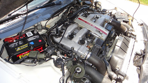

I'm Corvidae's roommate, and thought I might reply to this in order to let people see the car in question. It's his second Z, the first being a real beater of a 1990 NA that someone had horribly abused during previous ownership. We did our best to fix it up, but it just got to the point where just the cosmetic repairs would have cost almost as much as another car since we just didn't have the time and skill to do most of the work ourselves. So, he picked up this TT. Hopefully this seat problem can be fixed, but here're a couple pictures of the car.
