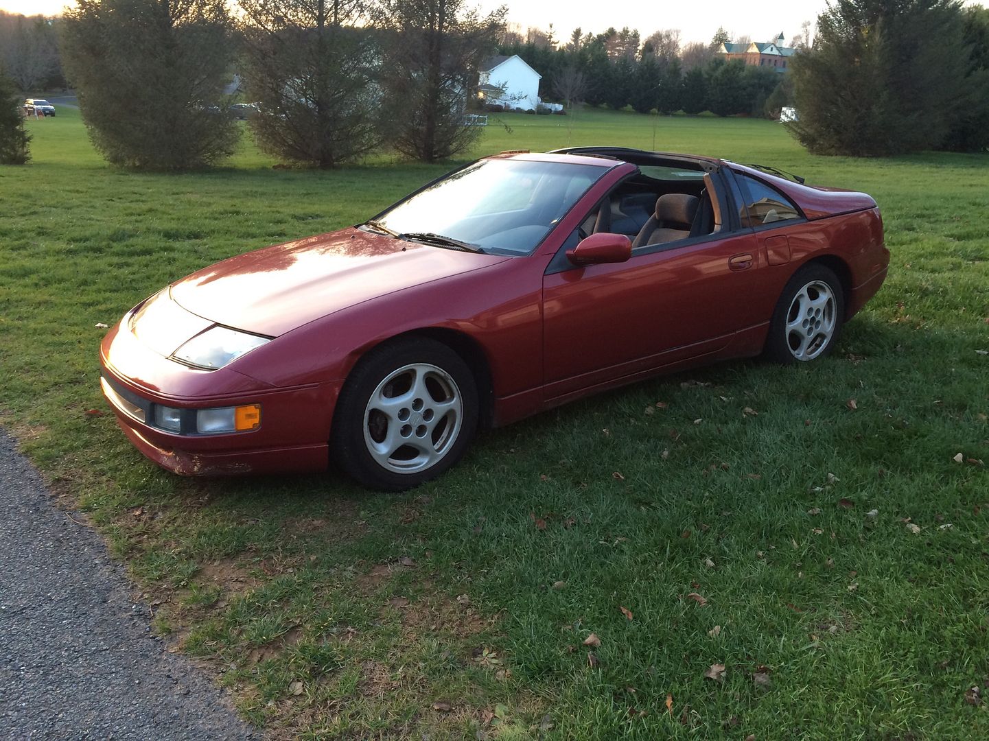

Been lurking here a while garthering info and wanted to share my project.
My name is BJ
Car is a one owner 1990 2 seater NA 5sp. 170,xxx miles, 100 percent stock. (Or at least it was)
It belonged to a friends dad. He bought it new back in fall of 1989.
I got a hold of it late fall of 2015. I've always wanted a z32. These cars came out when I was 11-12 years old and have loved the style of them ever since. I've owned a lot of different cars but this is my first z car. I worked as a Audi/Porchse/VW tech for a bunch of years so I always built dubs and Audi's in the past. Few off road trucks and bikes mixed in there and now I've finally got a z car.
Motor ran like crap when I bought it, transmission shifted great but had the typical worn out shifter linkage. From the start a motor swap was on the table since it was a NA car. I considered a 5.3ls swap due to having done a few of them on other platforms but felt it better to stick with a Nissan drivetrain. Plus I'd never seen a RB swapped z32 in person. Starting researching, taking notes and laying out a budget and time table.
So I've been tinkering on it in my spare time. I'd like to have it drivable in the next 2-3 months. Here's what I've done so far.......
