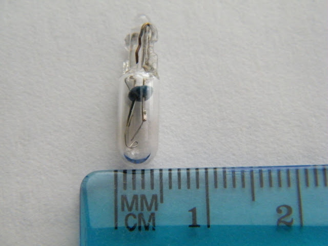

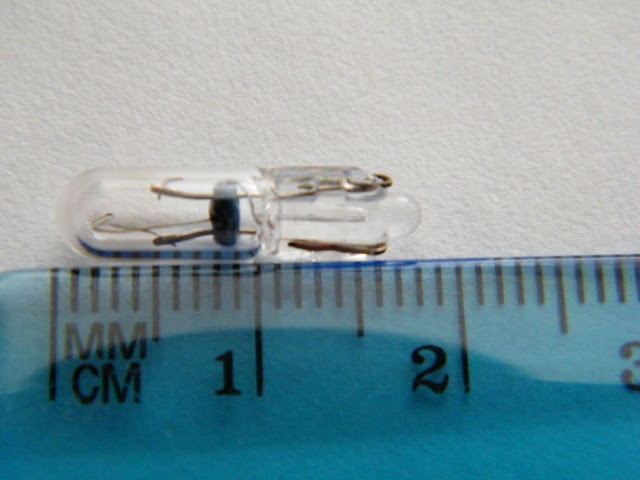

I am replacing some light bulbs in my dash board and I want to know if anyone has any OEM vent light bulbs. If you can read me off any numbers listed on the bulb?
I have called the local dealer and they have no listing for them what so ever. And I can't just go to the local parts store and match the bulb by size because there are some many different ones.
Or if anyone is going to a pick and pull just snap some pictures of the light bulbs....
Q451990
Posts: 11030
Location: Columbia, SC
It's a mini-wedge style bulb but I don't see any markings on the wattage. Here are some pictures.
I can't swear to it, but it looks like the same bulb that my '97 Hardbody used in the CHMSL - which Sylvania's site shows is a 2723. That bulb has a with a T-1.75 or T-1.5 base depending on which site you use to look up the specs. on that size. So if that's the right size, you just have to figure out the wattage. Might try some of those and see if they work for you.
