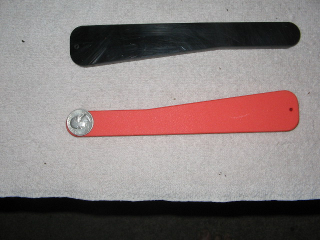

I have what you need. Email me or call me, $17.50 shipped where are you?
I'll email you a picture
Doctor510
[email protected] 602-550-4135 Arizona

As for the wedge - yes you do need to have a perfect, snug fit to stop the spring-loaded tensioner from popping out. In my case the custom-wedge made was not sufficient. This is probably what you're looking for: http://www.amazon.com/Alltrade-648831-N ... hain+wedge
Use caution... some wedges are actually for KA24 engines and are slightly shorter, they could have you end up redo your timing chain too. ;-)
Posts: 54538
The wedge pictured above is correct. Works good.

Im trying to scrape up some money. This head gasket failure was unexpected. Ive read about using a garden hose to shove down there to "keep the tensioner from popping apart".
Has anyone tried using a piece of hose to hold the tensioner back? If the tensioner comes out a bit, without falling apart, will i not be able to get the sprocket on? Because ive got some hose... But barely any money right now.
Thanks again
Posts: 54538
You'll cost yourself more money than the part. I'll loan you mine if you promise to send it back. Don't stick a hose in there, it's destined to fail.

Thank you! I shaved down a piece and its looking just like the picture of the wedge above. Its very thin. I really appreciate the offer, as well as the warning for people with garden hoses! I fortunately am safe at the moment and should be able to procure a wedge of my own design or either of the offered models. It definately wedges hard. I think ill put a touch of oil on the pine, then wedge it. May the force be with us, right!? definately have to drill a hole for the rope to pull it out later. I feel like i want to go for it. Its quite a step of faith.
