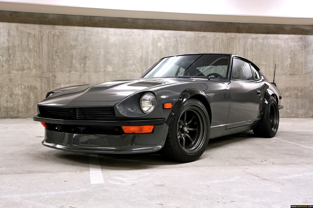

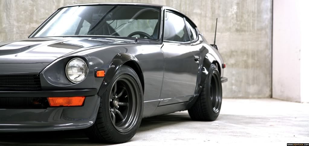

Here's a picture of 245/45's on 16x9's all around. Not too bad at all.
225, 245 or 255... Take your pick. But 45 profile for sure. With a +15 offset though, the 225's are probably the only ones that won't need a pull if you're really low. Thats way I said the 225's...

Those 245's fit it fairly well, but it looks like a 255 is a perfect fit. Then again, with different tires comes different tread width. Case in point, I have some A6 205's on 7 inch wheels that is a taller stack than my V710 215's on 8's.

^^^Exactly. I've seen some 245's sitting way more square on a 9 inch wheel than those above. They seem to look good on that car, though. But on an S13 with 16x9+15's? Get ready for some fender work or about -3 degrees of camber up front...
