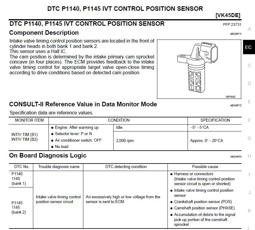

from the FSM:
Code 1140 is problem with Bank 1
Code 1145 is problem with Bank 2
In the illustration below
The Bank 2 sensor (the LEFT side picture with a number 1) is on the passenger side near the power steering fluid reservoir-you'll have to remove the engine cover-easy
The Bank 1 sensor (the RIGHT side picture with a number 2)-i know they could've done a better job of labeling is on the driver side near the oil dipstick-you'll have to remove the air intake-also easy
Looks like they are attached by a "fixing" bolt--don't know the size, though.
Hope this helps, gl with replacing them
