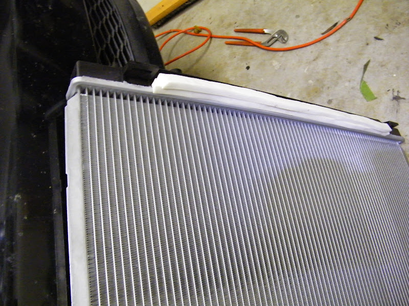

Here's a side x side of the old and new radiators. You can see the tabs that hold up the a/c evaporator on the bottom tanks of both units.
I added some foam weatherstripping from Home Depot that I had laying around in the garage to the new radiator to replicate the foam seal on the old one.
Be sure to transfer the top and bottom spacers from the old radiator to the new one. The studs on the bottom of the new radiator are a little smaller than the OEM ones, so after having them fall off a couple of times - I put them in the radiator support and then sat the radiator in to them instead of trying to keep them on the studs.
