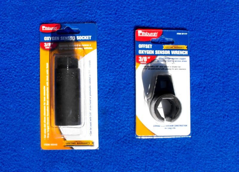

I must admit - I dreaded changing O2 sensors like it was a root canal..
Almost by accident, I purchased two types of O2 sensor tools from Harbor Freight. I figured one or the other tool types would work. As it turned out one was better for the left side than the other.
On the left (drivers side) I used this one:
http://www.harborfreight.com/3-8-eighth ... 95045.html
On the right (passenger side) this one worked better.
http://www.harborfreight.com/3-8-eighth ... 97177.html
So for less than $14, I bought the tools I needed.
I've got some pictures of these tools in action that I will add to my photobucket and post in a few here today.

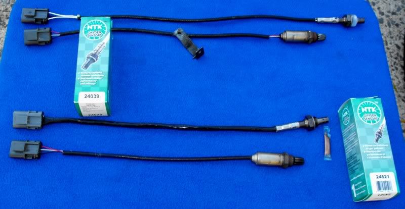

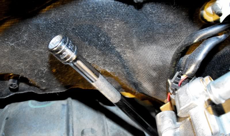

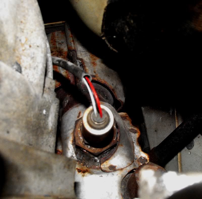

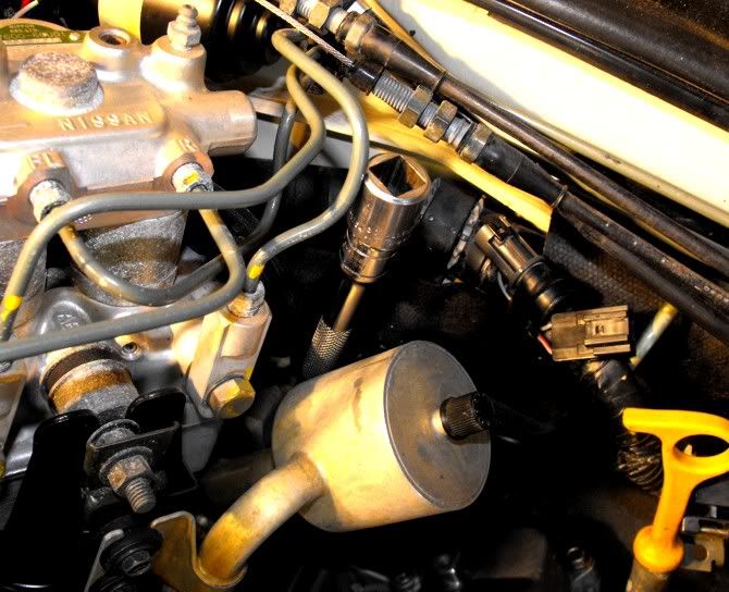

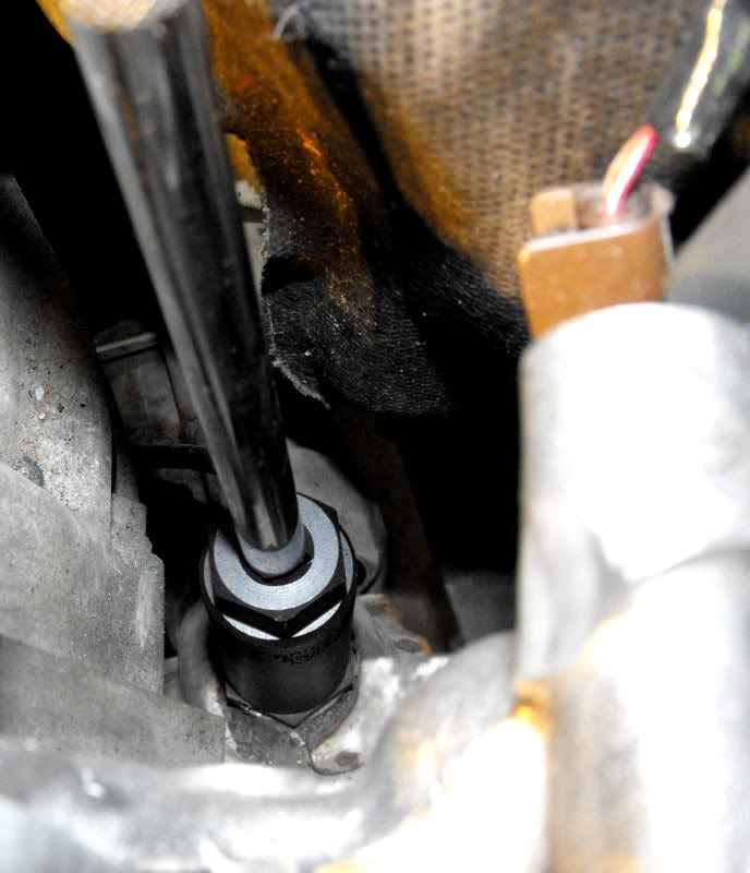

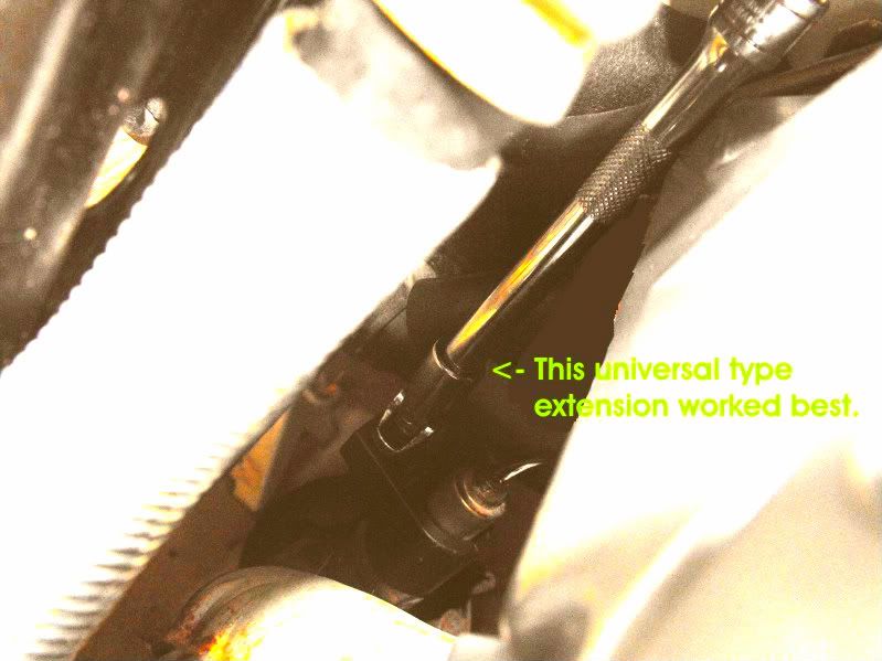

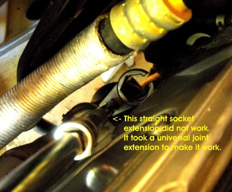

Some pictures from the O2 sensor job..
Note: I crawled up into the engine compartment and stretched out over the engine to take these pictures. I used a couple of layers poly foam as padding so I could stretch out over the engine and radiator fan shroud. The need to crawl into the engine compartment will depend on your physical size, along with arm and leg length. Personally I found it easier than trying to reach across the fenders and engine – but it just depends on your preference. Also, I had many components already removed from the engine that facilitated the O2 sensor pictures. Experiences from other members can help determine your final approach.
Helpful tools.
New O2 sensors. Other members have sources for the best deal.
The driver side (left) O2 sensor.

Positioning the extension along the firewall and bell housing to loosen the driver side O2 sensor.
An unsuccessful attempt to remove the passenger (right) side O2 sensor with a straight extension.
A look at the passenger side O2 sensor with universal joint extension and angled removal tool.
Running the passenger side (right) socket extensions along the firewall and down to the universal joint and and tool in the previous picture.
