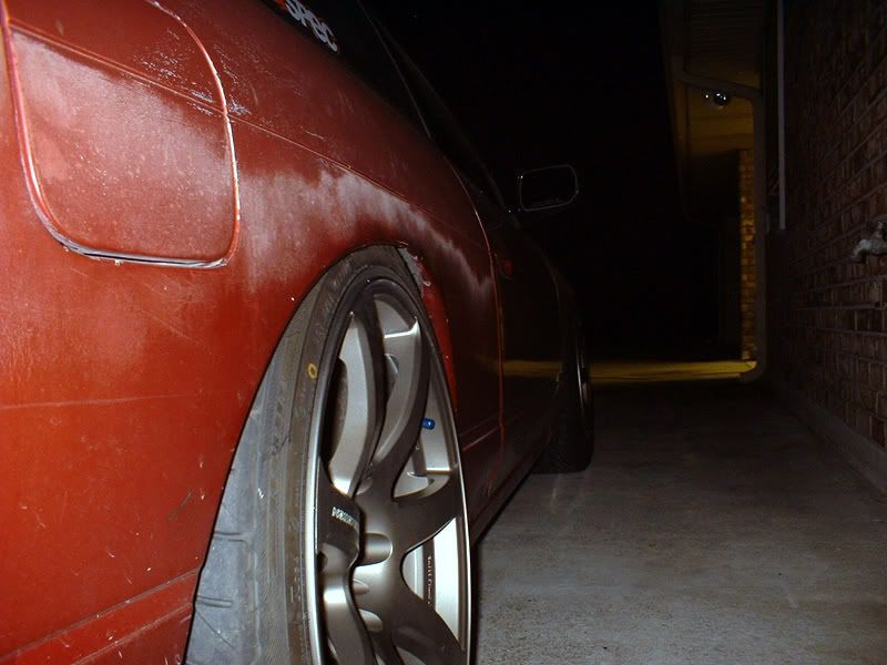

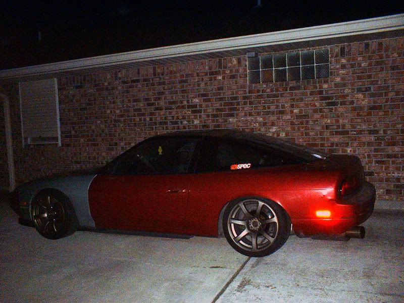

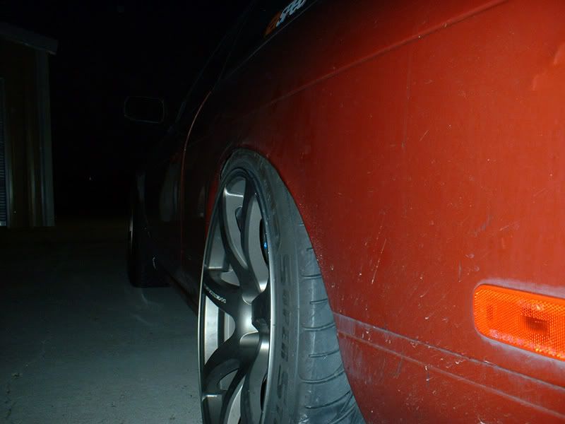

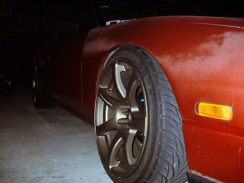

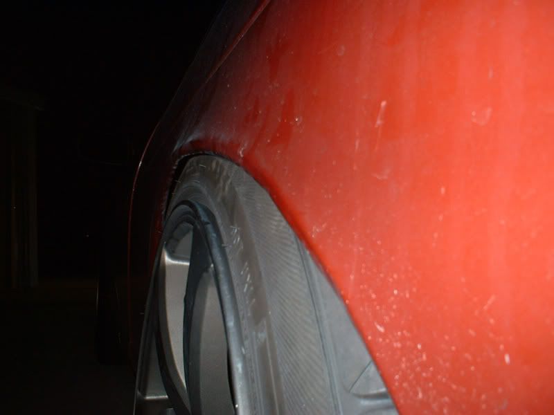

 « Re: (babowc)
•Grenade GX-01s
•17 front and rear
•9J front and rear
• + 15 all around
• Clears Nismo G-attack/R-tune coilovers
• no other suspension yet
•highly recommend to have rear fenders rolled, as i can not got lower on them
• 235/45/17 all around
Sorry for crappy pictures, will get some during daytime
