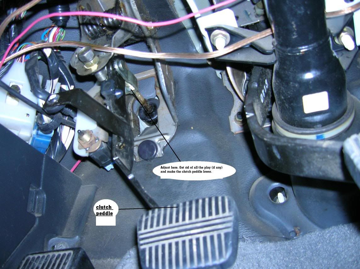

I have one in my car, its only about a week old and its slipping, BADLY. I dont know if it was improper installation or what, but I think I will go Exedy OEM.
It looks like the rate of success is about 50%. I think it grabs good, but only half the time.
I am getting it looked at this week, if it turns out to be something other than the actual clutch itself. I like the bite and the way it feels, but I dont like the slipping.

you probably have to adjust the clutch pedal. I had to. It felt like it was slipping but it was actually the peddle that just needed to be adjusted lower. fixed mine and it works so0o good now. I hope you find out what it is.

two questions:
1. how to you adjust the clutch pedal
2. is it possible to re-seat the clutch if the break-in was not proper.

1.
2. Yes. by re-seat, i think you meant, re-set. if so, yes you can re-adjust the pedal.
Mine had a lotta play and was preloading the cylinder so it was like i was pressing down the clutch and riding it all day long. So i had to shorten my clutch pedal. play with that, i'm sure thats what happened. Good luck bro. I hope i hellped.
Edit: pic is a lot smaller than i thougth. All i said in there was "adjust here and get rid of all play (if any) and lower the clutch pedal".
