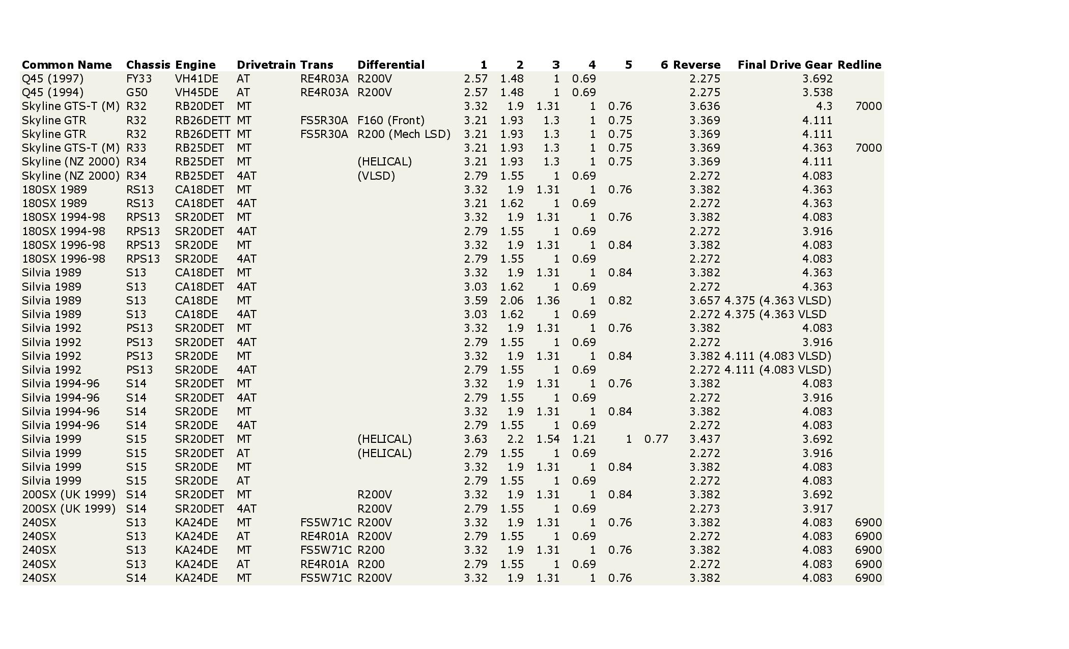

Okay, so I found which nissan has the 4.636 fd that fits a 240 and it's from the "front" diff of a 2001 xterra "se". There's also a 4.90 that fits the 240 diff from a 2004 xterra.
The owner of a turbo'd 260whp 240 says the 4.6 much better("the difference is night and day in a good way"), an auto cross 240 owner says it's also better cause he doesn't have to downshift like before to get more acceleration, a drifter said he can drift in 4th gear now where he used to have to shift down to 3rd, and an n/a ka owner says it's a great bang for the buck upgrade because n/a ka's need as much of an edge as it can get and 0-100mph is much quicker now.(I know the speedo is not the same with a 4.6)

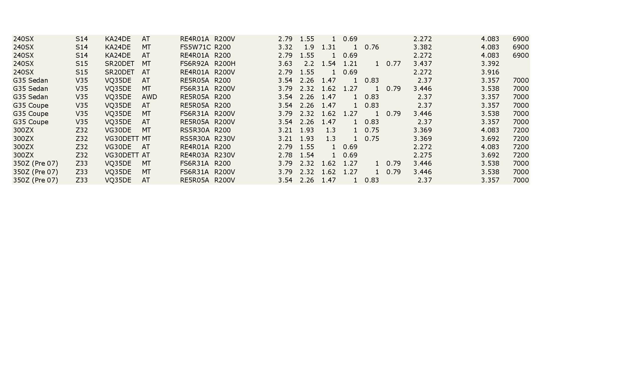

working4aS13 wrote:*Update* Nissan Gear Ratios Excel SheetModified by working4aS13 at 12:53 PM 2/18/2007
S15 Spec R MT Final Drive is 3.692! Redline is 7100.
