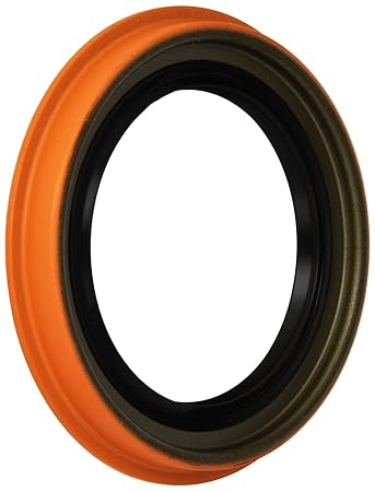

Seal: National 710072

Glad to hear it! This reminds me, the last time I did the bearings I used a Timken 710072 seal instead. It has a lip on the outer edge so you can blindly hammer it in and once it's seated be guaranteed to be perfectly level. Foolproof is a big selling point for me!
