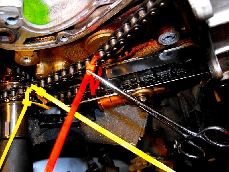

Thank you very much. What’s the purpose of the colored zip ties?
OwnerCS
Posts: 1771
Joined: Thu May 27, 2010 4:34 am
Infinitiace1992 wrote:
Wed Oct 14, 2020 8:07 pm
To hold the chain in place so it stays put while changing the guides. Some people use mechanics wire to hold the chains in place. You don't want the cams to slip and jump a notch while the chain is loose for changing the guides. No color significance. I was what I happened to have that day.

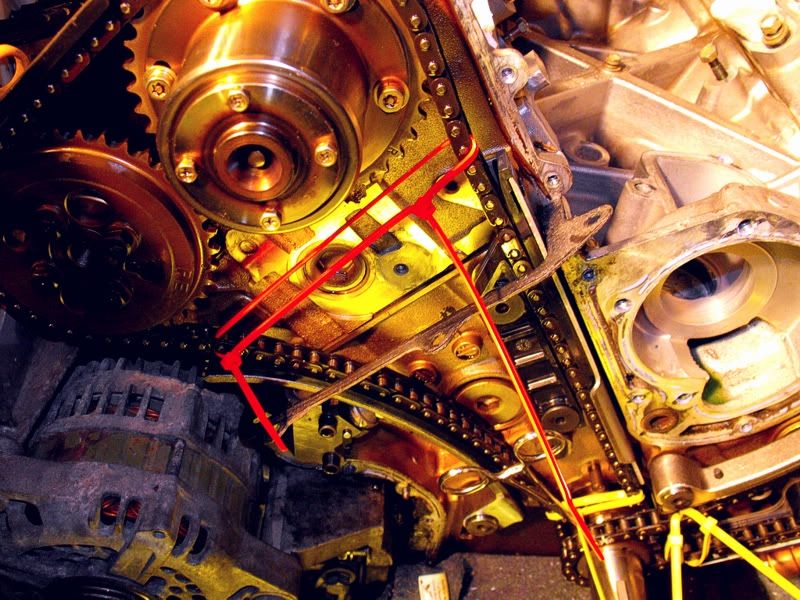

So I’m finally in the process of installing the new timing chains, tensioner, water pump, injectors and several other items installed, I thought for those of us that may not have seen a VH45DE (Q45) motor Internally I’d post a few pics. Pretty advanced for an engine designed in the late 80’s.

Ace- I can't zoom your pictures (but thanx for posting them!)....Please show us your old guides and how they look at your age and mileage.
The VH45DE was incredibly advanced for it's day.
Don't forget the super duper torq on the crank bolt (friction drives the oil pump sprocket). 270 lb-ft (260 absolute minimum).

Thanks Jay. I’ll be sure we do crank that to 270. The plastic guide on the driver side of the engine was totally destroyed. I bought the car with 69500 original mikes on it with original plastic guides. I’ll try and post a video of how the engine sounded when I bought it this summer. I knew what the problem was the old owner didn’t. The chain was rattling around but thankfully it held with no internal damage especially for an interference engine. Can you post videos here?
