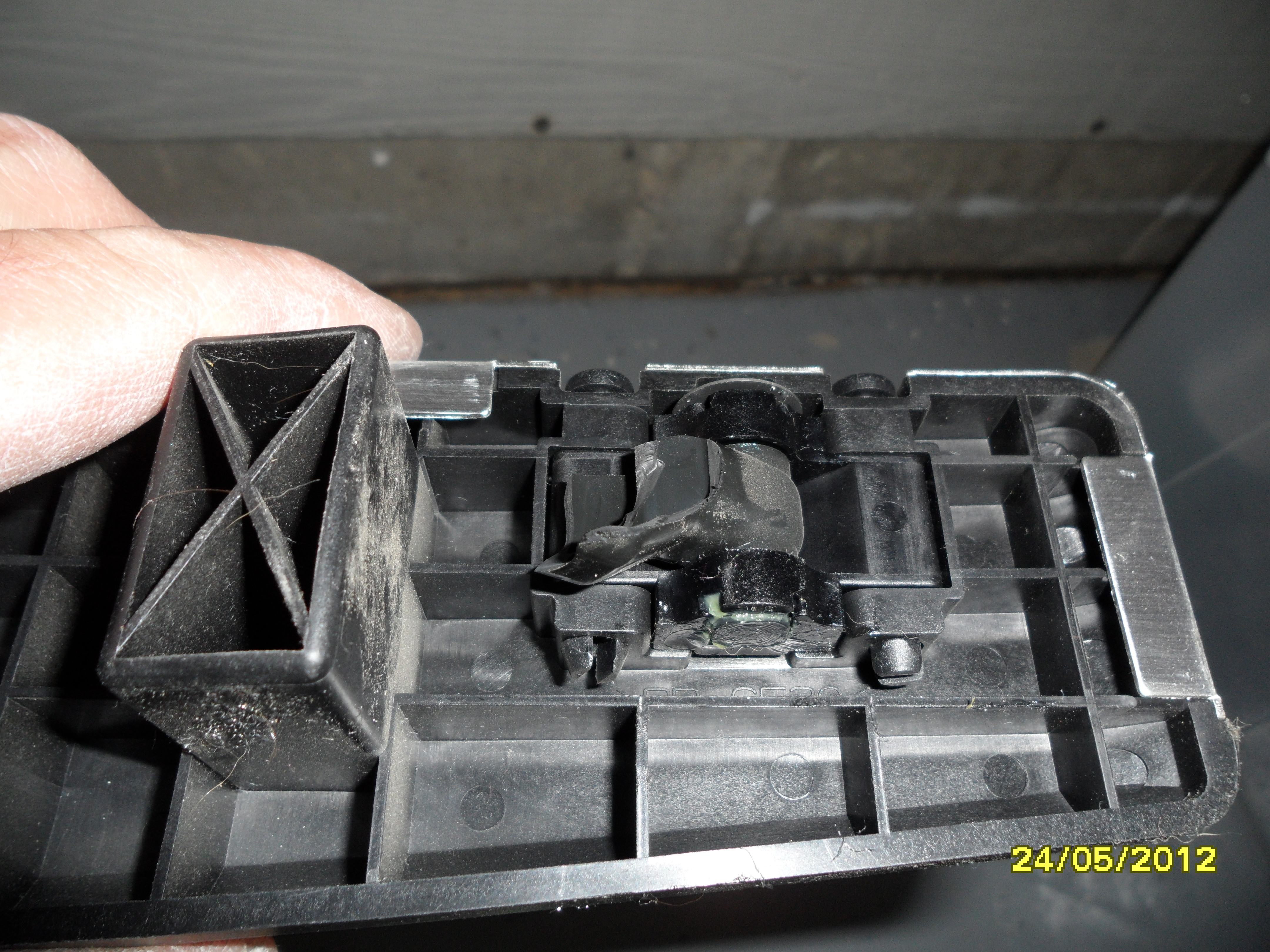

Next is the tricky part: removing the two plastic pins that retain the pedal to the link. Unless you know what you're dealing with, you'll break it (as I did). Fortunately, the part the breaks comes with the new APPS.
Use needle-nose pliers to squeeze the end of each pin. IIRC, the part needed to be squeezed on mine was facing the right side of the pedal, and I assume that bent-nose pliers would have been necessary.
I broke my link before I figured out how to remove the pins:
Better pic of the pins:

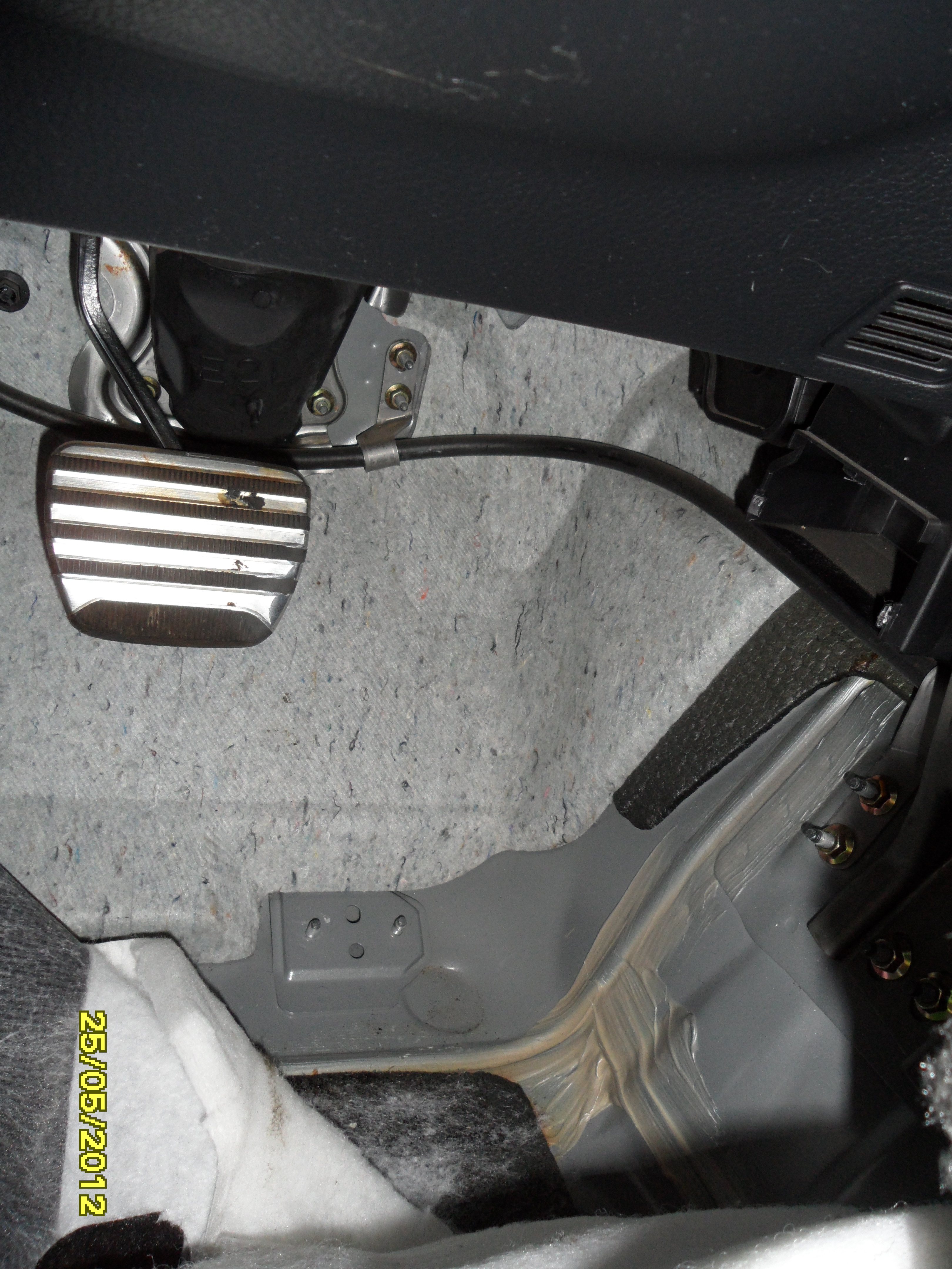

Remove the vent from the left/upper side of the tunnel:
Carefully pull back the carpeting to reveal two more 10mm nuts to remove, then begin manouvering the old APPS down. I admit, I cannot recall if there was one more fastener higher, but I don't think so. Once you've begun to pull it down, you'll have to snake your hand to the top of it and remove one cable guide/clip, and then disengage the harness from the APPS.
