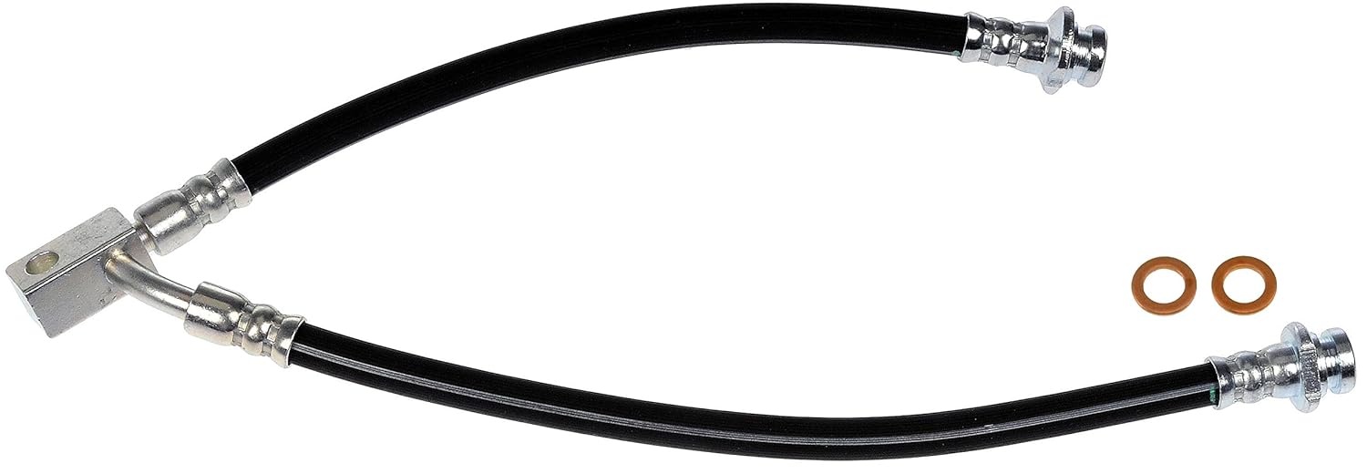

For some late model 2012's and all 2013+ M/Q's. If your front brake hose looks like this then you'll need to buy additional hardware.
You need to buy these additional parts:
46245-JK60B Brake Tube RH
46246-JK60B Brake Tube LH
54314-JK60A Brake Hose Braket RH
54315-JK60A Brake Hose Braket LH
