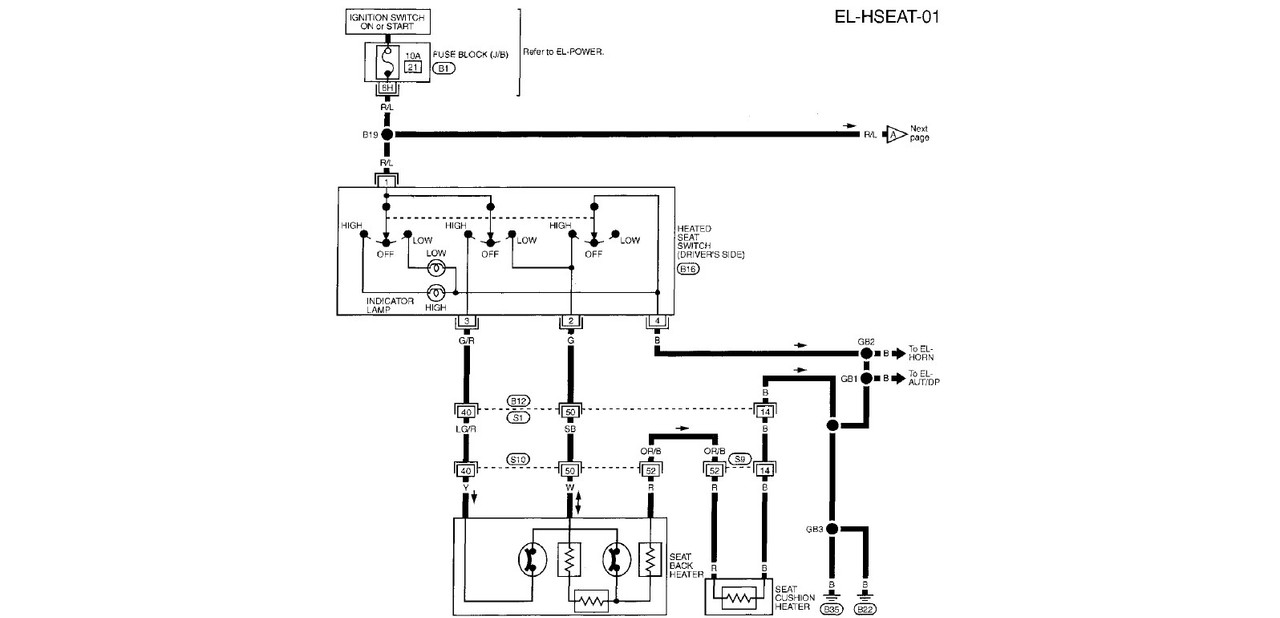

Here's the schematic excerpt:
the elements are the same for hi or low, but the current flow thru the elements (heat dissipation) is switched.

So it definitely sounds like the switch then.
Off to eBay.
Thanks for the confirmation, guys.
