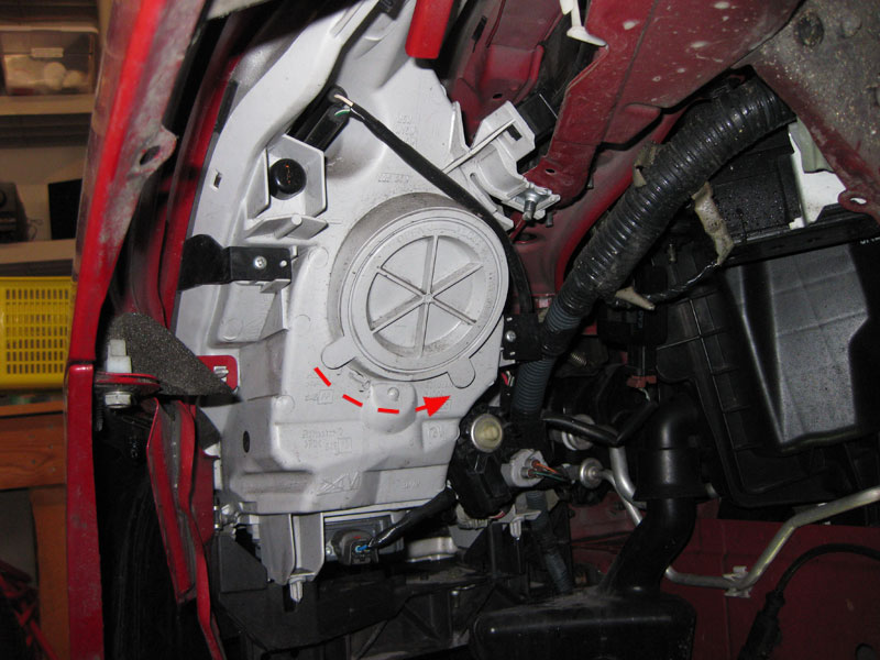

I was wanna change the bulbs of my parking lights. I have tried to bring the parking bulbs out of its socket in headlight but in vain. I can grab the wire only :( Does anyone know that how can we change the bulbs of parking lights in front headlight. I have 2008 G35x.

You follow the wire to the "stalk" and twist it. The parking bulb is the upper-left that has the two wires running to it.
Note: your housing may look somewhat different as the one pictured has AFS
The above pic is from a HID how-to: http://www.moodym.com/articles/G-hid-replace.shtml

Is it necessary to remove tire to change bulbs of parking lights ? Can we just untwist the holder to uninstall the bulbs of parking lights ?

You have to pull the inner fender liner out of the way so I would suggest removing the tire for access
