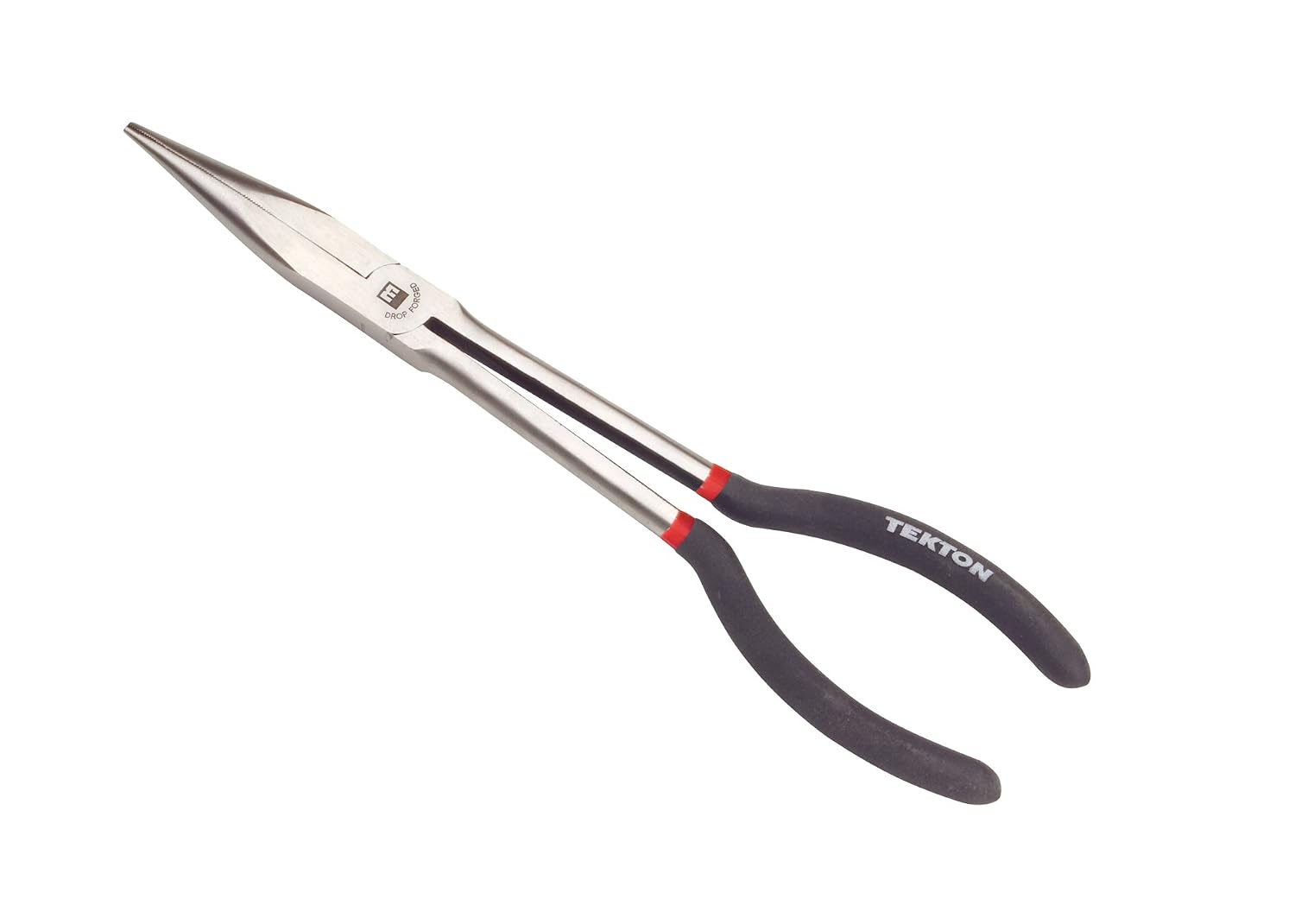

I had to use long needle nose pliers the first time I took them out. Turn slowly until it pops open so you don't break anything.

Debonair, I tried needle nose pliers but could not get enough turning room.
Thank you for your help. I think maybe I need to do both. Looking forward to the picture.

Success!! Between moving the clips and some long pliers I was able to get it done. Thanks again.
