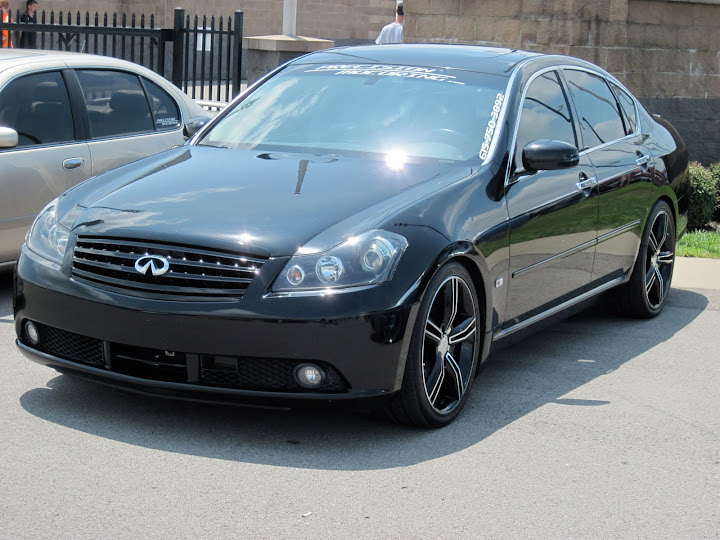

Car Model: M35x
Struts and Springs: K Sport coilovers
Tire/Wheel Dimensions: 20x8.5 +35mm 255/35
Ride Quality Dropped: 7 (a little bumpy, but the car handles and steers much better)
