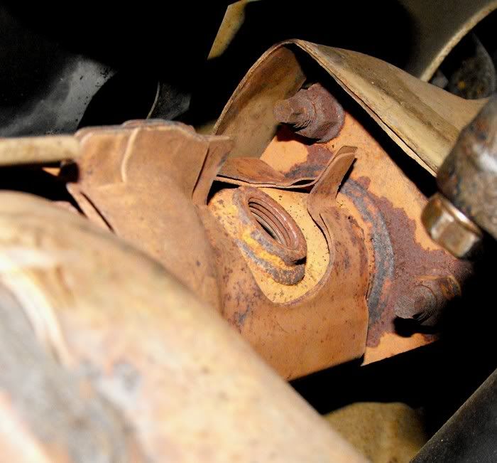

04) With the O2 sensor removed, the hole in the exhaust is in clear sight.
