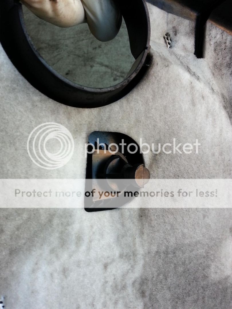

Cylinder #5 (A little Tricky)
^Some might say why the swivel portion well i know swivels rob some power when removing stuff but this is why i used it so i can have the extension clear the tab from blocking
Then i used my long extension and my long 3/8 ratchet that has leverage
