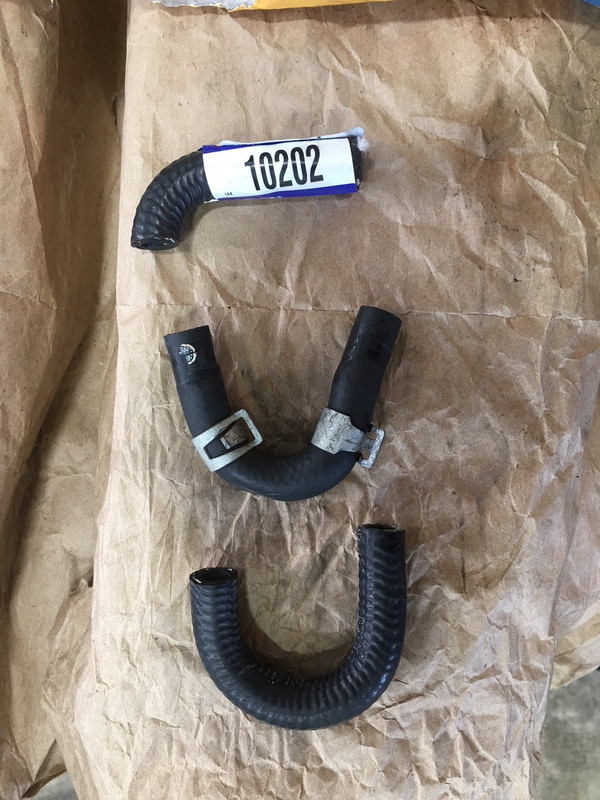

So for the few of us that are maintaining their 1st gen Q's, the lack of Nissan parts support means getting creative. I'm slowly putting together a list of options, particularly related to plenum hoses.
Nissan used very high quality (and purposeful) rubber, I for example have some 25 year old factory rubber that not only doesn't leak, but is still somewhat pliable. Still, deterioration is inevitable.....
There are 4 hose functions that immediately come to mind:
1) water/coolant
2) gasoline
3) air/vapor
4) petroleum fluid
each of these came from the factory with a compatible rubber formulation, so generic replacements must respect the type.
1) The water/coolant hoses are EPDM rubber and are not compatible with gasoline, may not be compatible with other petroleum products. EPDM can be used with all modern coolants including OAT, hOAT, water wetter, and the generic 'green/yellow' ethylene glycol coolant. Gates rubber claims to offer an EPDM hose that meets SAE20R3- class D1 standards.
https://www.gates.com/us/en/fluid-power ... /p/p100826
D1 suffix is important because it denotes "improved service" and the use of EPDM compounds.
Gates/NAPA are presently branding a line of 'electrochemically resistant' small diameter cooling hoses, but in two samples (one Gates branded and one NAPA branded), I could not verify that the actual hose meets class D1 standards (it is not marked as such, and the samples do not have the smooth outer jacket as shown in the Gates catalog).
I did however cut to fit a portion of the NAPA 10202/Gates 18202 hose in place of the 14056-64U04 obsolete factory hose (14056NA in the online parts diagrams) that goes between the throttle body (or air-cut control on some TCS cars) and the plenum EGR. It has now been in service for 100 miles and 10 cycles and does not leak. I reused the factory 16439-56S00 clamps on this hose.
...more to follow

2) for gasoline hoses, the factory used something called "hiprex'. it holds up well, there is some debate about it being rated for E10, as of course the Japanese engineers in the late 80s never contemplated this. I highly recommend the current issue Nissan bulk hose for replacement--just cut to fit:
A6440-N7686. It is labeled "FPM/ECO" It's pricey!, but..... The ECO rubber is the shizzle..it goes by the trade name 'hydrin'. FPM is a high grade fluroelastomer (see 'Viton'). The same Nissan fuel hose is used on a lot of newer cars so it is E10 and probably higher E20 compatible plus, it simply doesn't leak. for anyone that has used 'fuel injection hose' under their plenum and gets tired of the cold morning gas smell...the Nissan bulk hose works! Note the FPM/ECO is not suitable for use with coolants.

Those ebay hoses sure look purty. that particular listing is only for the 2 hoses that are at the bottom of the valley. Factory part numbers for those two hoses are:
14055-f6511 and 14055-60u60 they are still available, but one could also get the same nissan rubber for less by cutting small lengths of bulk hose (both of those pieces are short and straight).
as for the fuel injection hose clamps, I would definitely use the nice round screw type (NOT worm drive). the factory clamps are #16439-53A00, and of course they fit perfectly, don't leak and would get full marks at a car show. I do find that the phillips heads can wear/get sloppy over time. and they can be difficult to access when the octoplenum is in place. most of the aftermarket pieces have 7mm hex heads which are more user friendly. be sure to use the correct size, as those have a smaller clamping range.
