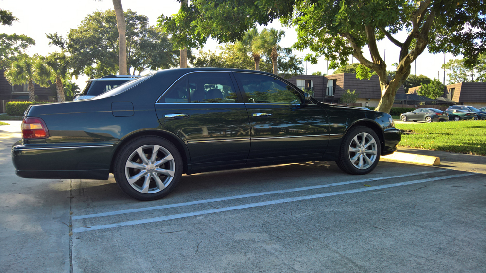

That's a beautiful Q HansCC

Thank you -
BadQ gave me a lot of help here on this forum -
Miles - 69k - trouble is its 20 years old now - seals and plastic starting to rot -
Replaced valve gaskets but still hunting down another oil leak. I run synthetic.
Changed out MAS body when I changed out the lights...
And still a bit sluggish on slow throttle response but not bad - hoping its not knock sensors
Thinking possibly about new injectors and fuel filter ... 02 sensors been changed but that was 2 years ago.
Let us know how your light issue goes - thx
