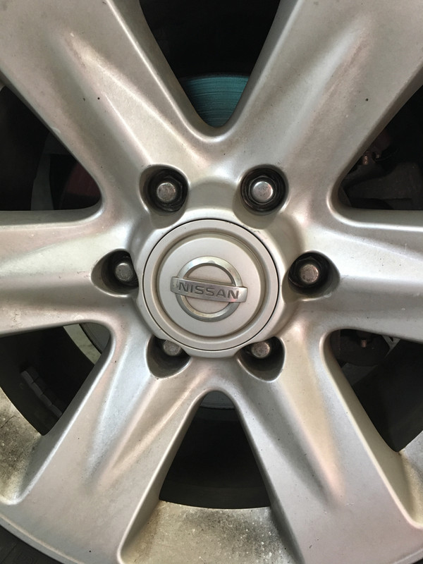

Howdy,
I recently purchased a 2002 Nissan Pathfinder LE. I previously drove my 1996 and I installed Warn hubs on it and had hopes of moving them to the newer Pathy; however, it doesn't look like my current wheels will allow it without modification or replacement.
I've searched for a while but cannot seem to find definitive answers to this, but if someone else has installed manual hubs with this wheel:
1) Did you modify the wheel so the hubs would fit? If so, how?
2) Is there a different manual hub that will fit with the current wheels?
3) If you swapped wheels, which did you go with?
I highly doubt I'll ever off-road with the car but I am looking to have a little better MPG (I can't get above 240 miles to the tank and that's after multiple fuel treatments, new fuel filter, spark plugs, Spectre air filter, etc.) and less wear on the axles. The tires are size P245/65R17.
Thanks for any tips and suggestions!

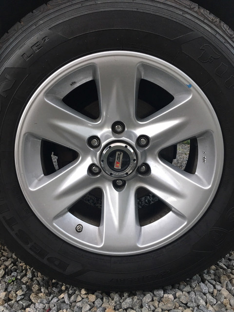

Did these fit without spacers? I have the same rims. I'd like to do this, but I'm seeing different info on if they fit without modifications.
TY
Aaron
mdmellott
Posts: 1269
Joined: Mon Sep 02, 2019 3:32 pm
Car: '13 Kia Soul+ 2.0L AT
'02 Pathfinder SE 3.5L AT P/4WD
Location: SF Bay Area, CA
No modifications or wheel spacers needed on those wheels for those manual locking hubs. The wheels I have on my '02 SE did require a cutout modification to the hub/nut cover. I went with Warn 29091 hubs on my '02, which are a bit larger than the Rugged Ridge hubs so they probably wouldn't fit those wheels on the '02 LE. With a careful cutout in the plastic cover, salvaging the Nissan badge in the center and sticking onto the Warn hub with heavy-duty mounting tape, the look of it came out very nice.
download/file.php?mode=view&id=3571
