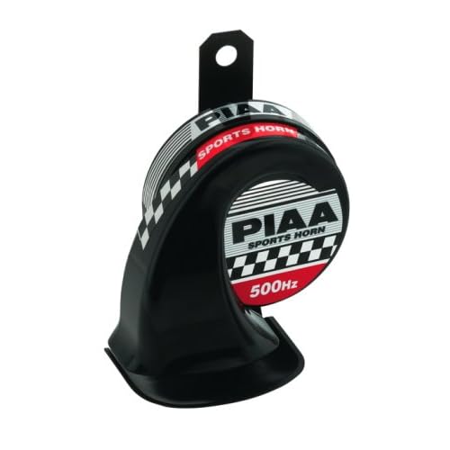

I'm bored, so I decided to order some new horns to replace the stock horns... hey come in a pair of 400 and 500 Hz. Should get them by next weekend, I hope.

fueler wrote: when you install the horn, is it better to have the actual opening for the horn tucked behind the grill, or at the opening of the grill (where fresh air is hitting it)
With the style of horn pictured above, you want the opening to face down. The reason is to prevent water from getting in and staying inside the diaphram mechanism.
The stock horn is round and has a metal shield that sits in front of the horn cone and the way it is designed, it is mostly protected from the weather and water isn't really an issue.
Also, I've only seen one horn on the PF...upper rad support on the P-side. Where is the second horn?
Also, if you want maximum loudness, I would install a relay. That way, the horn will get maximum voltage when you press the button.

Well, I'm not sure what you were expecting. The PIAA Sports Horns are close to the "beefiest" horns there are for automobiles. The only thing that is noticeably louder are the big rig trucks and train air horns and then boat air horns.
Did you mean you wanted something with a lower frequency tone? More thump, than bump? I don't think there are many loud but low frequency horns out there for automobiles. The lowest after market frequency I saw was 300 kHz... which isn't much different.

Dang... it took over two months for me to finally install the horns I bought.
I'm not sure if I should be disappointed... from inside the cabin, the PIAA horns sound about the same as the stock horns... from outside, it does sound a little louder.
